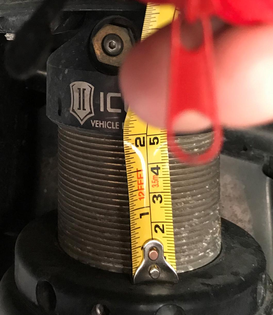

your at a 3.75" lift with still a tiny bit more to go (if you want higher). Why dont you lower your fronts down some (i think 1/4" of threads is 1/2" lift?) so 2" threads - 0.25" = 1.75" threads (which youll be close to shrub1 - he might have a 0.1" to a 0.25" on you).

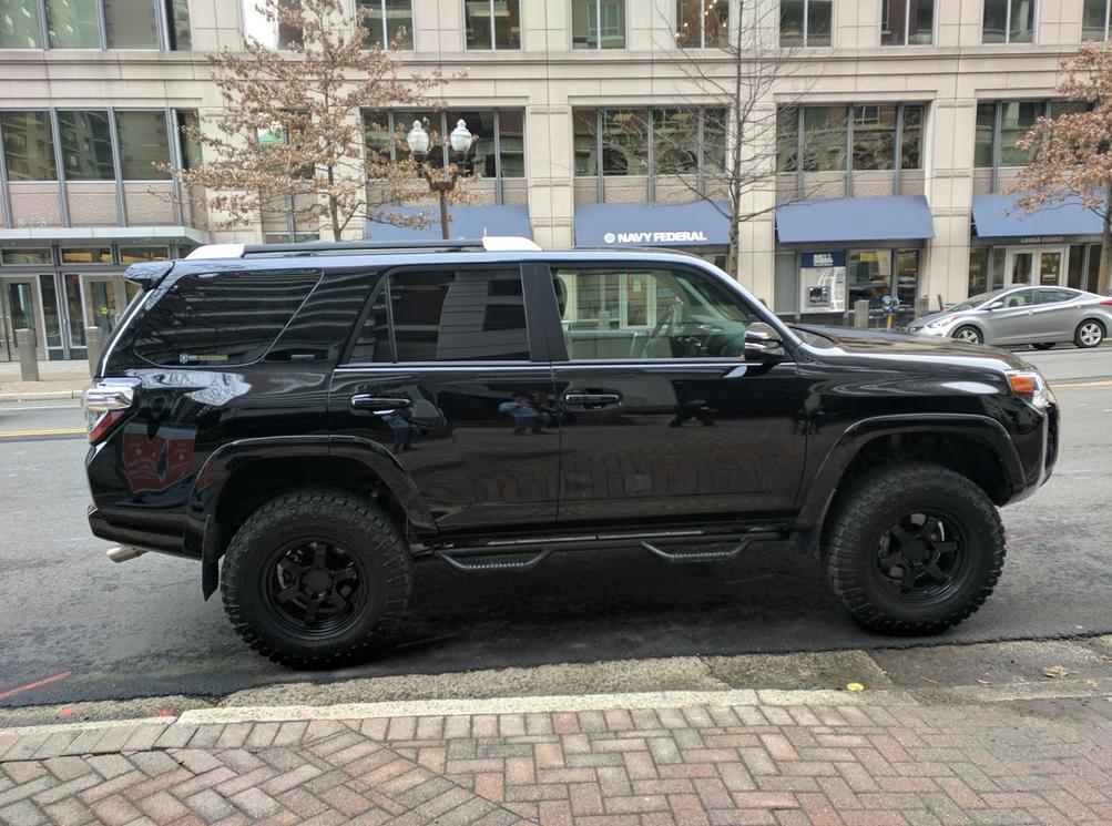

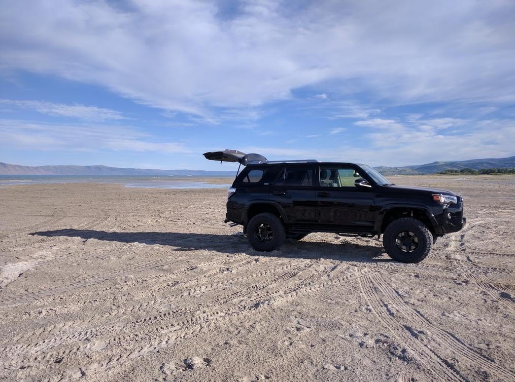

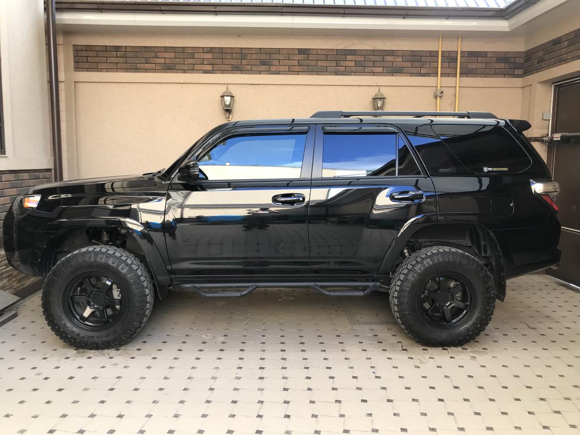

I finally got the new 3 inch icon rear spring and got it installed. It is hard to notice from the pictures, but in person it made huge difference. I can see the road little better now, my front hood does not come up as much. Also the cargo in the rear does not slight back to the door anymore(more level).
Here is some more photos
Before rear spring install:
attachment.php
Another one before install here:
attachment.php
After:
attachment.php
This is where the preloads are at:
attachment.php
As of right now front measurement from center front hub to fender line:
Front 23.5 inch from center hub to fender line
Rear 24.5 inch from center hub to fender line
