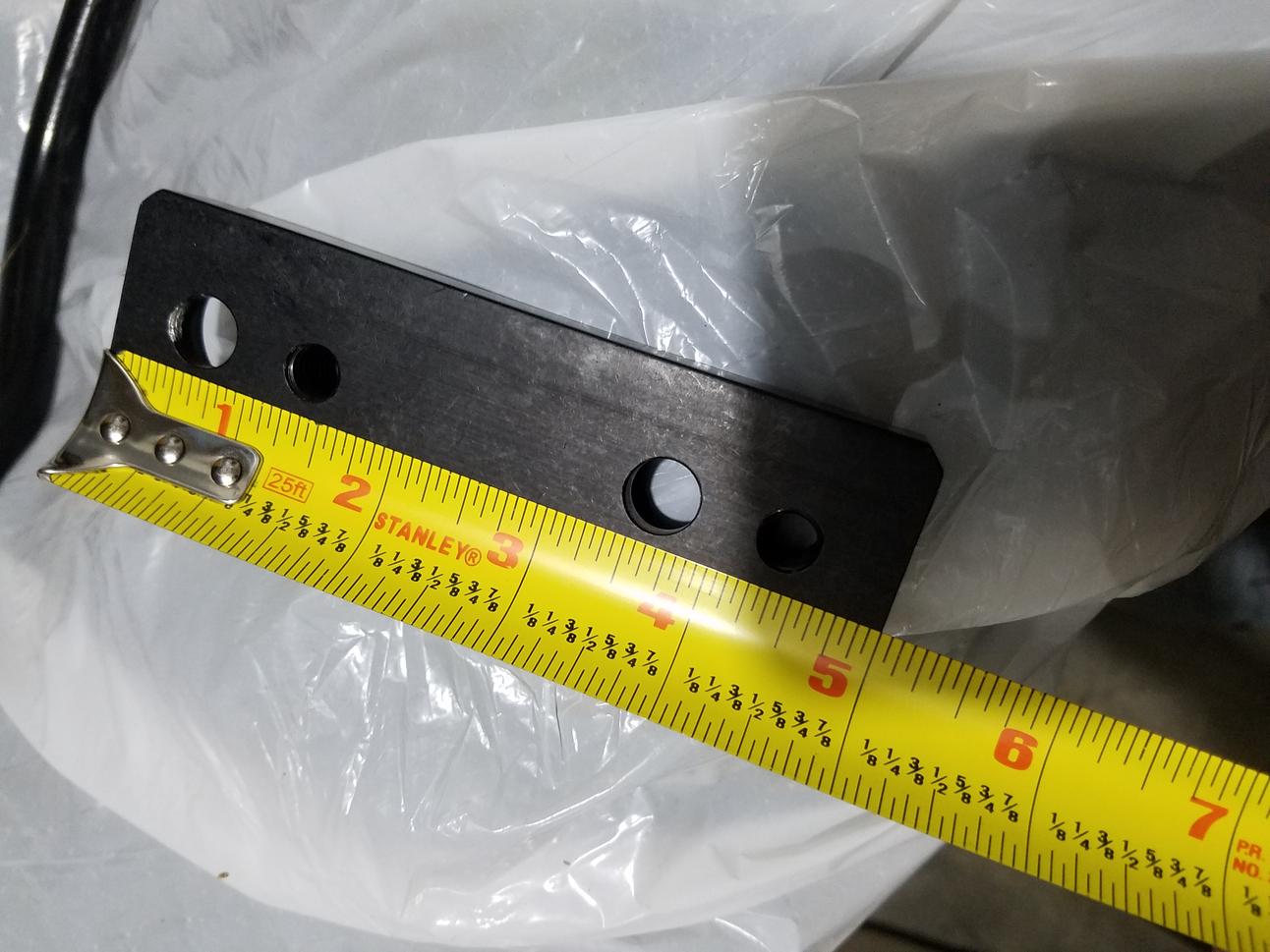

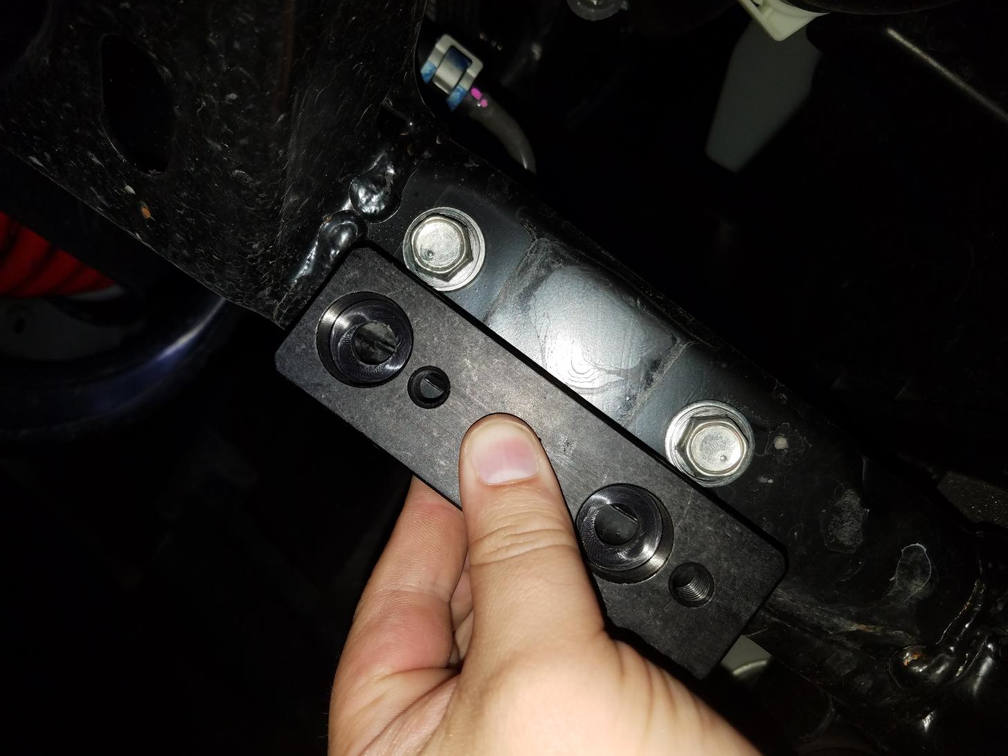

Everywhere I look these SKUs are the same for the 10+ FJ and 4runner. I got mine with a kit for the 4runner. I have not received a response from Icon yet, so I figured I would try here.
Mine have the holes too close together. Its off by a good 3/8" of an inch or so. It cannot be drilled out. I have tried and it still comes up short. The only thing I can think of is that they gave me one for an 07-09 Tacoma/4Runner. Its the only other product that shares the same image on their website.
Can anyone confirm if the 07-09 Tacoma or 4Runner sway bar bracket frame holes would be closer together? I know this is a long shot, but I was hoping someone had both vehicles or has run into this issue. Just so I can tell Icon what they actually sent me. I dont want them thinking its user error, or that I have a unicorn frame on my 4Runner.

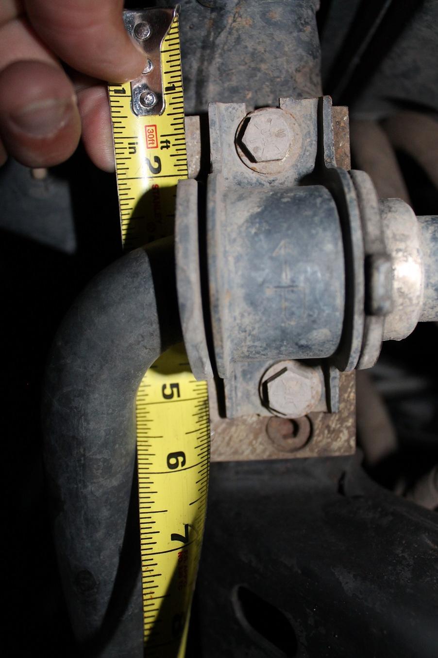

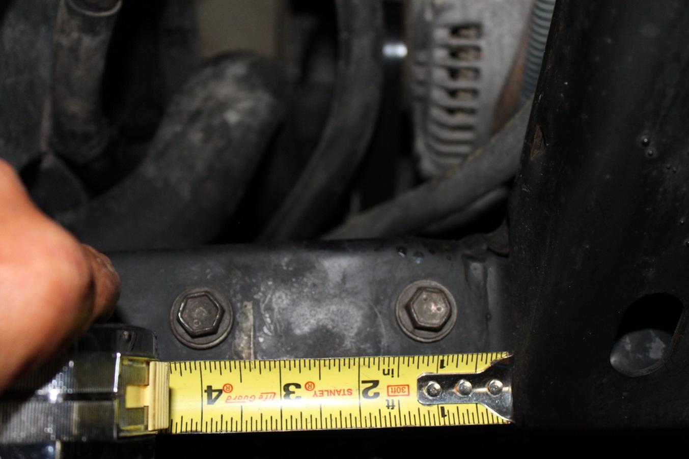

I think your theory might be right. The first pic is my 2012 Limited w the King spacer/reservoir bracket. That is the factory sway bar bracket so the spacing might be the same as yours.

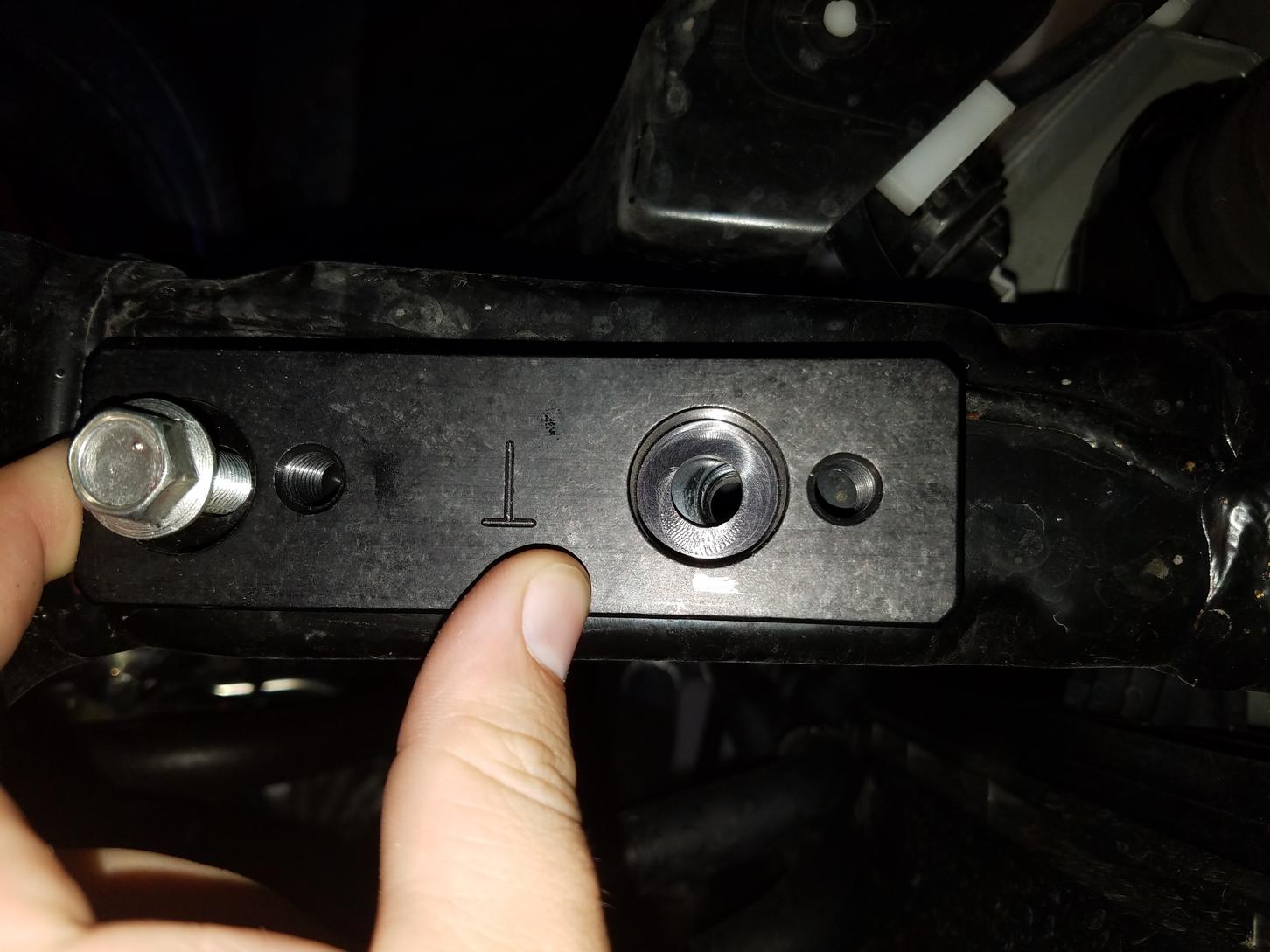

2nd pic is of my 2003. It's up on jack stands with suspension torn down so the angle of the pic is a little different. But I think you might be right about the 3/8" difference between the 4th and 5th gens. Come to think of it the sway bar did seem smaller in diameter when I bought the 4th. PO had already taken it off and we threw it in the back when I bought it.

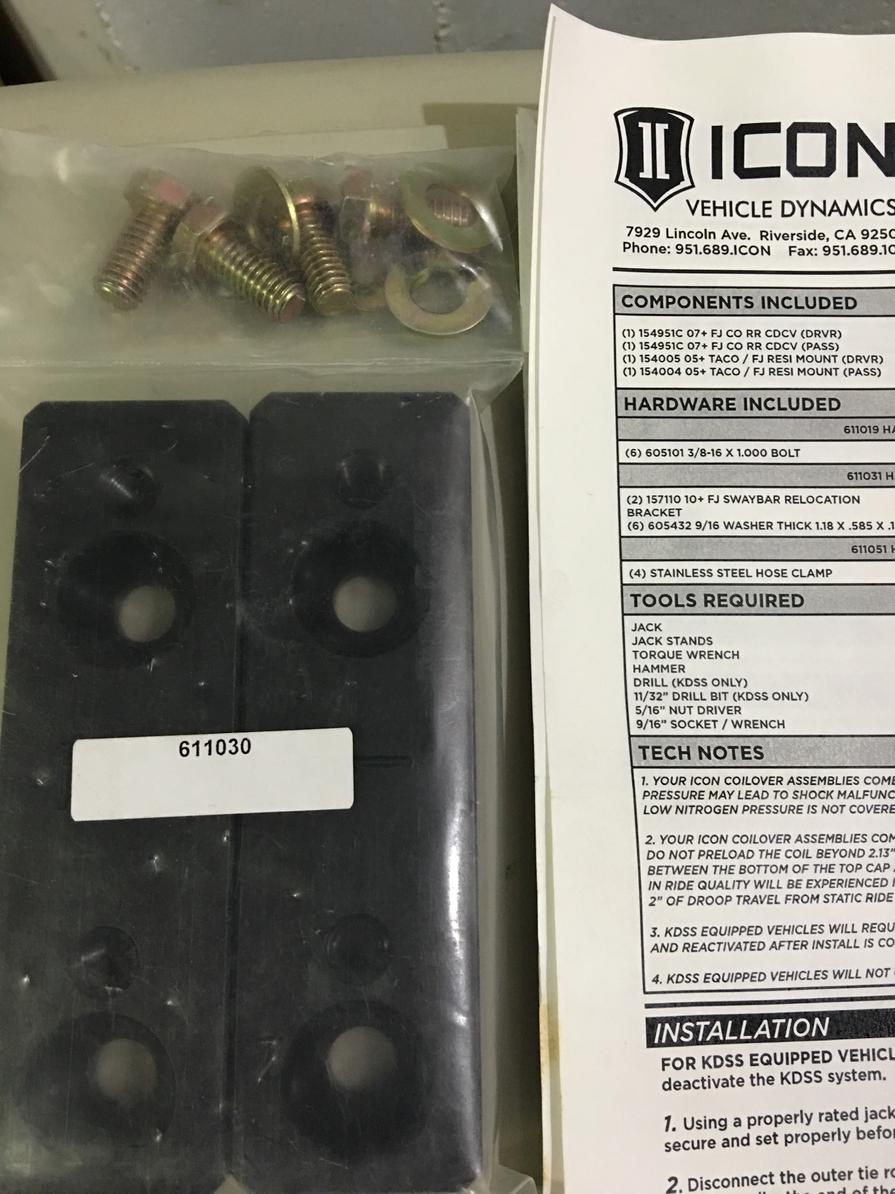

First, I don't have KDSS. I double checked my kit before install and realized I received the wrong ones after confirming with Icon. They also sent me the new parts and emailed me the updated instructions.
In the first pic, the 611030 part number is incorrect and the 611031, in the second pic, is the correct part number.

Sorry, I meant to include pics. I've updated the original post with a few I had on my phone.
From the images posted, it looks like I do have the 4th gen bracket. My tape measure shot isnt the best but it looks to be about 3" from center to center, like the 03 pictured above.
Also, I don't have the packaging or that would have been the sure giveaway! Thank you guys for confirming the theory. I will see if Icon will send me the right bracket after I destroyed what was already sent to me.
