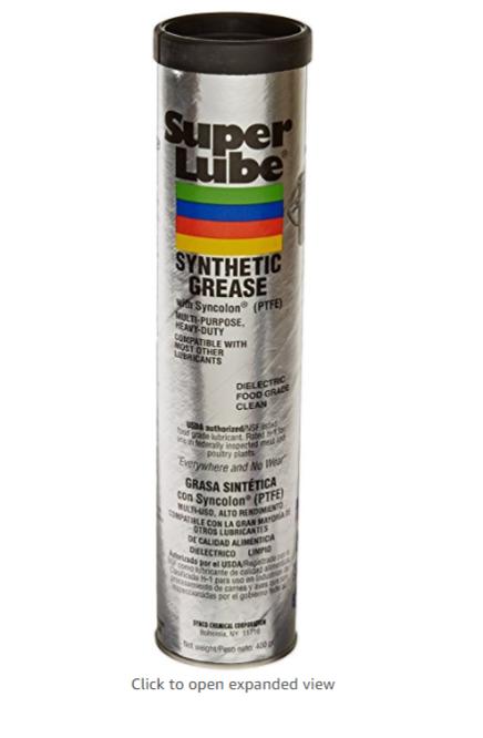

Is there a special grease I need to use on these bushings? I think they're polyeurathane.
Use this grease and only this one on the bushings. Loosen through bolt before pumping into zerks or bushings will deform and be ruined.
according to ICON, any NLGI lithium type multipurpose grease is fine. you can use the same stuff you use for your driveline U-joints.
Grease with any kind of oil or petroleum base will eat the polyurethane. I used drive line grease on mine and within 6 weeks they were pretty much mush. I had to replace them, but ICON happily sold me new ones.
i've heard that before. rubber reacts negatively to petroleum, but opinions both supporting and debunking that claim re: poly abound. i called ICON about it directly and they advised that it was fine.
but... 6 weeks? damn. i greased mine with Mobil 1 synthetic 4 years ago. no problems.

Earlier in the thread, someone recommended this:
Lucas Red N Tacky
https://lucasoil.com/products/grease/red-n-tacky-grease
Is this acceptable?
Still Petroleum based, I wouldn't use it, but looks like some people haven't had issues. The super lube is what comes with Energy Suspension Poly bushings. It's not expensive and you can easily get from amazon. Absolutely safe on Poly, safe to eat actually as its used in food machinery.
Copy that.
I have just Amazon'd myself a few tubes. I'm trying to wait to replace the bushings until after my Warn Winch Bumper arrives in a week or two, and I can install it and the winch. Then I'll have the shop replace all the bushings, re-adjust ride height and re-align.

Kind of a pain cause you need two grease guns to service the truck, but I'd rather not worry about poisoning the bushings rather than servicing them.
Just make sure you loosen the through bolt prior to greasing, let the shop know this as well.
