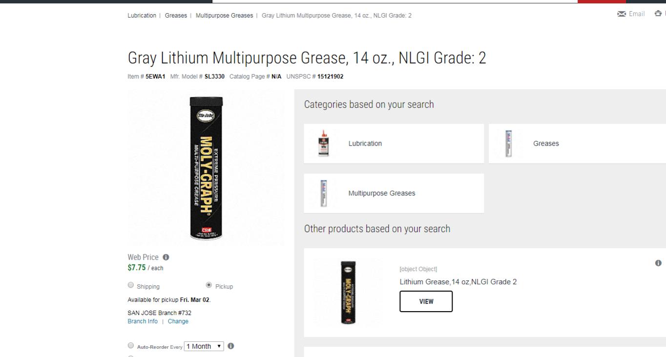

Used this,
ooooohhhhh... now i understand why your UCA bushings were destroyed — that's moly grease! it's spec'd for metal-to-metal sliding contact; as Toyota does for the driveshaft slip yokes (and i mentioned above).
i suspect your bushings would have been absolutely A-OK with a regular (no moly) NLGI grease; as Toyota specs for your u-joints (and as ICON advised me directly).
it's not a case of "petroleum-based" at all — it's the moly additive that is wholly inappropriate for the application of the UCA bushings.
thanks for posting that. i think it clears up a lot and may help to better inform folks going forward.
