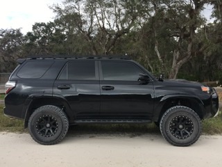

Yes, you can easily adjust them to your liking. Mine are right about in the middle of the threads and I am measuring 38.5” floor to top of wheel well in the front and 39.5” in the rear. Perfect stance in my opinion and great ride quality.

Here is my ICON stage 2 w/ extended travel option installed with the factory settings
Front has a lot more rake then I expected, I have since adjusted the front to be levelish, it 's pretty easy to do albeit tight to get the wrench in the slots.
