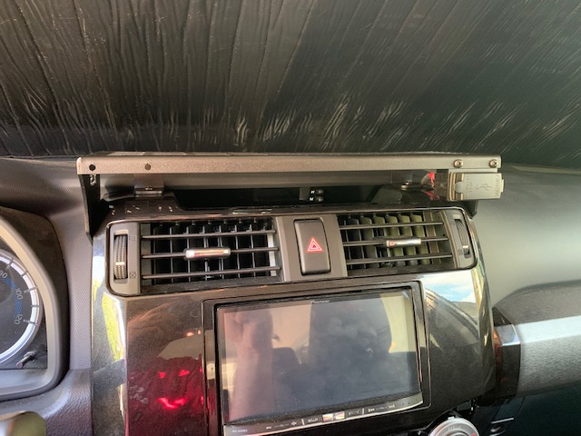

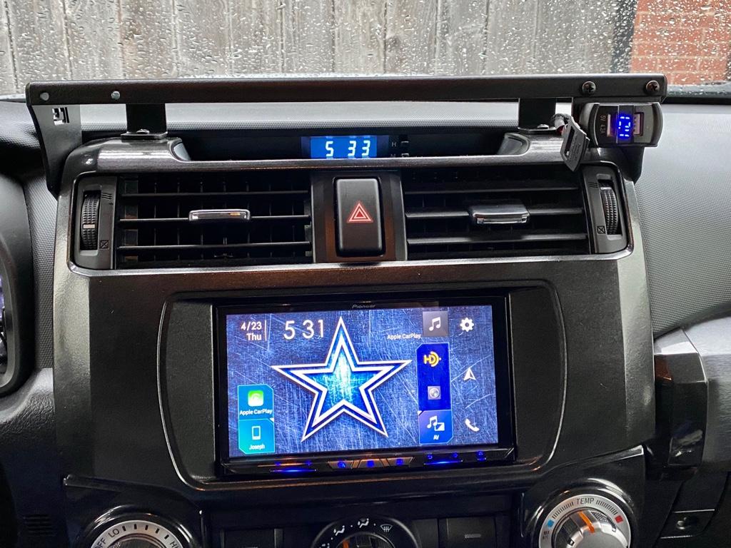

I did not receive my ICS Fab mount until Wednesday afternoon. I spent most of Thursday struggling with one fitment issue. The forward "struts" are bent at right angles to the main deck. The right strut matched my 2018's bezel just fine as it is angular. However the left strut was a problem because the bezel's side is rounded, not squared off. Simply bolting the strut down would warp the bezel which would not mate back into the dash properly. I managed to add some "curve" to the strut and obtain a fairly perfect fit.

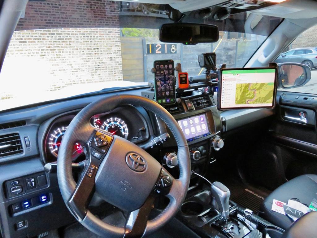

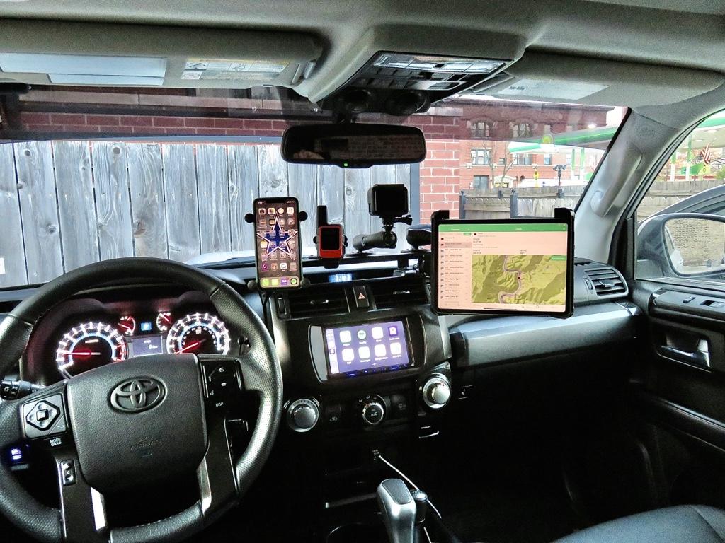

The deck now has my satellite messenger on a RAM mount, my Engel fridge's temperature display and my radar detector. For the latter I just lashed it down with zip ties until I can come up with a cradle.
For USB power I utilized some existing items I had on hand to provide 4 outlets.

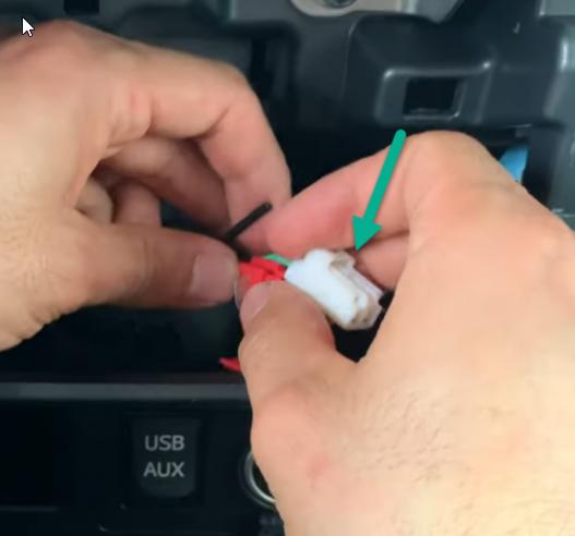

-the insulation on the harness provided by ICS is thicker than what's on your car. easiest way is to just strip it (ics harness) beforehand and use the bite connector after the fact.
-just pull the center console plastics. it will be SIGNIFICANTLY easier. i have large hands. it took me about 15 minutes of violating the 12v socket just to get the stupid connector out.

Hi [MENTION=380932]jaemz[/MENTION], would you be so kind yo point me in the right direction for the 67 design mounts. I will be installing 2 iphones, 1 ipad and a go pro. Thanks in advanced!!!
