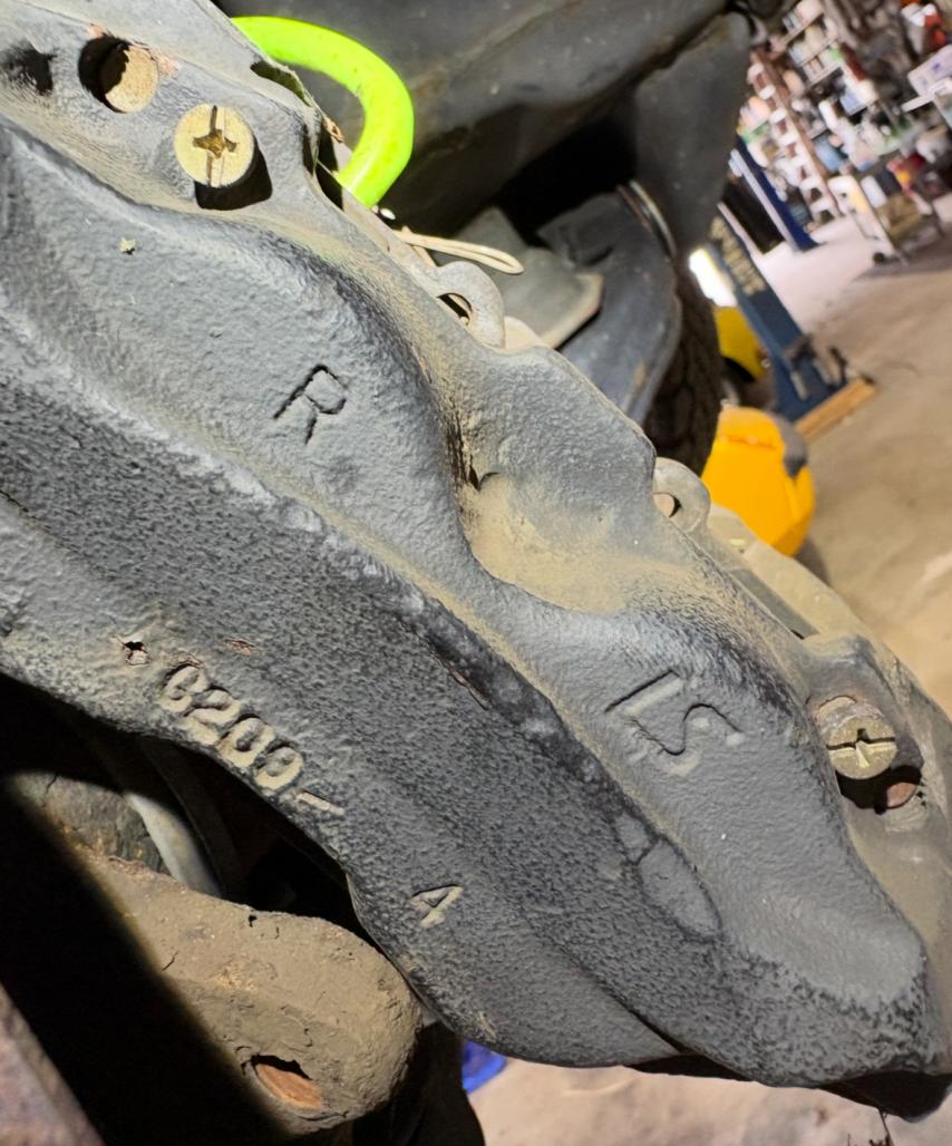

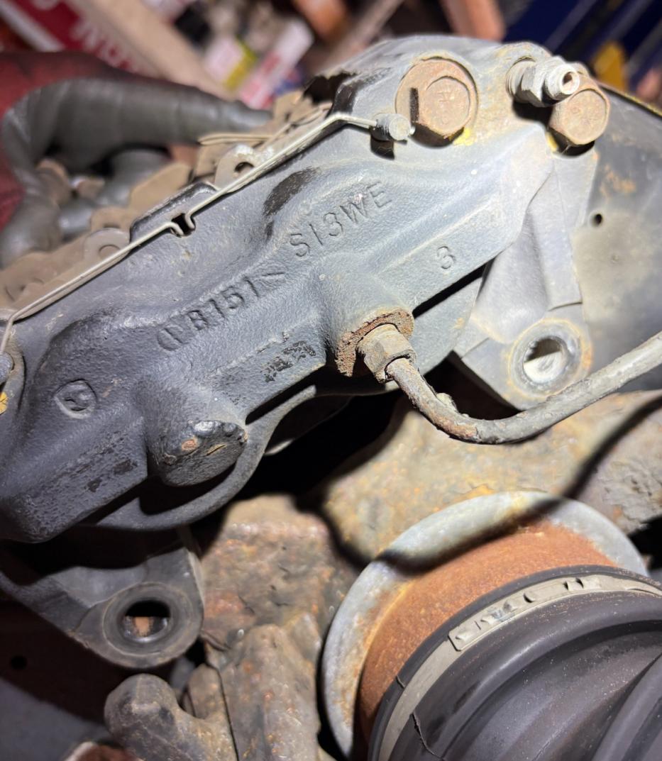

Caliper is locked up wonder if anyone can identify this? Wondering if it’s Napa. OEM, probably should replace with the same thing yes ?

The stamping S13WE on the caliper suggests that someone performed a Tundra brake upgrade on this vehicle, using the smaller 199mm caliper. Looks OEM to me. If rebuilding is an option, the rebuild kit very cheap from the dealership, I used it to rebuild the S13WE calipers I put on my 4Runner.
If you're looking to replace them entirely with the same caliper, you'll need to look up the Caliper for a Toyota Tundra, from what I remember most of the calipers you can look up for these are going to be rebuilt anyway. I don't have my repair log on me, so I can't tell you which Tundra I pulled my S13WE caliper to help you find the exact part. Someone else may be able to chime in and help in that aspect
Yes this is correct, calipers and rotors have been upgraded. When looking for a kit or replacement caliper what year tundra should I reference? Thanks
From what I can find online, 99 - 03ish Tundras use the 199mm S13WE caliper (Tundra brake upgrade onto Tacoma S13WE - YotaTech Forums)
03ish - 06 Tundras will have the larger 231 mm caliper (13WL Brake Upgrade | Toyota Tundra Forum)
Note about both threads I linked: The second thread says that 2002 Tundras could potentially have the 231 mm caliper. The first also suggests 03 will have 199mm S13WE, while the second suggests 03 will have the 231mm S13WL.
I would err on the side of being safe and choose a kit that guarantees a fitment with an earlier Tundra, that should guarantee it's a S13WE caliper. I am currently not home, when I get home I will edit my post to include the exact model of Tundra I pulled my calipers off for reference.
Edit: I pulled my calipers off of a 2000 Toyota Tundra
I believe the 13we ended in 2003.. But you can double check when ordering from auto parts places, they will usually list if its a 13we or a 13wl. i know my 2002 tundra has the 13we on it as I did its brakes this past fall.
