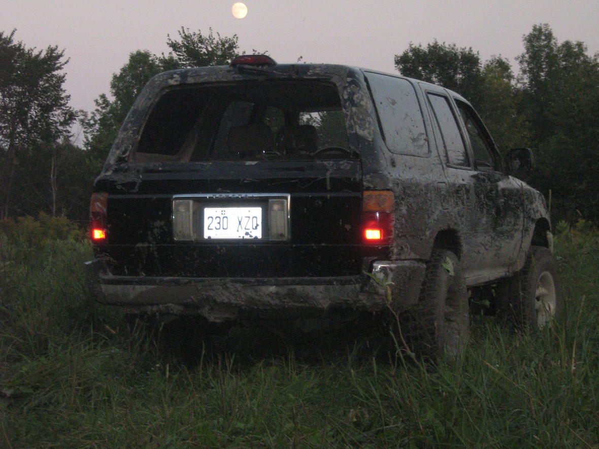

My 22R in my 94 runner has been acting up in the last few weeks. My idle goes up and down as if i'd be pressing the gas, even after she's warmed up...
wires? or EFI ? does anyone know where i can find bigger wires on the net, everyone here only sells stock wires...
