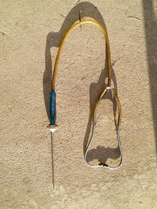

Home now, I don't have a problem with fan wind noise with this one, you can hear the swish/swish noises quite clearly when used.
Hope you find what all got damaged in there, and stay out of the muddy/sandy waters next time. IMG_20140412_073212.jpg
Hope you find what all got damaged in there, and stay out of the muddy/sandy waters next time.View attachment 116194
Very similar to the one I have. Works great, as long as you are careful where the probe is going when the engine is running...............
