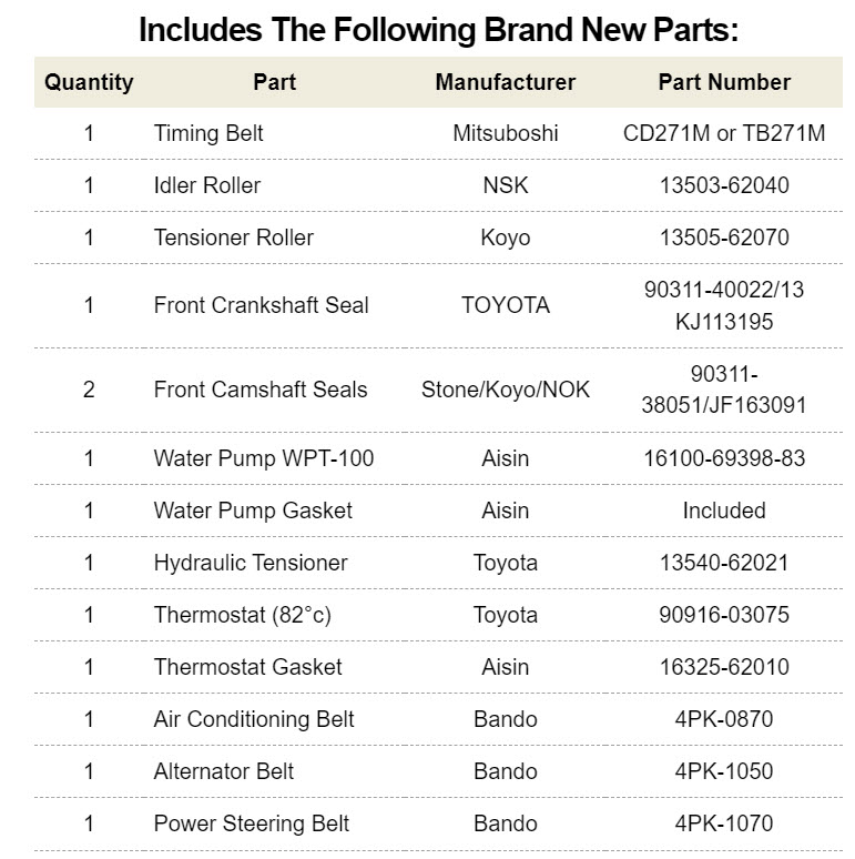

The vehicle has 196kish miles and I did the timing belt, water pump and all the associated parts with this OEM kit (screenshot attached) about 2 years and 8k miles ago.

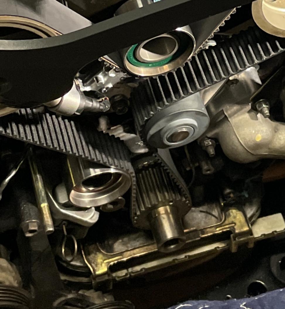

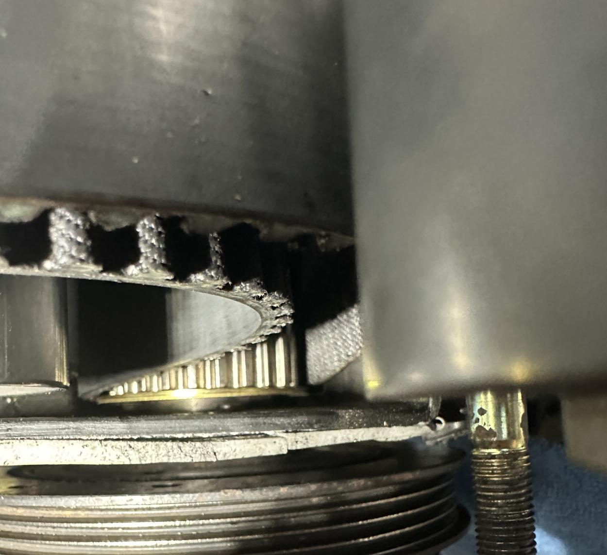

The top picture is from today with slack on the belt.

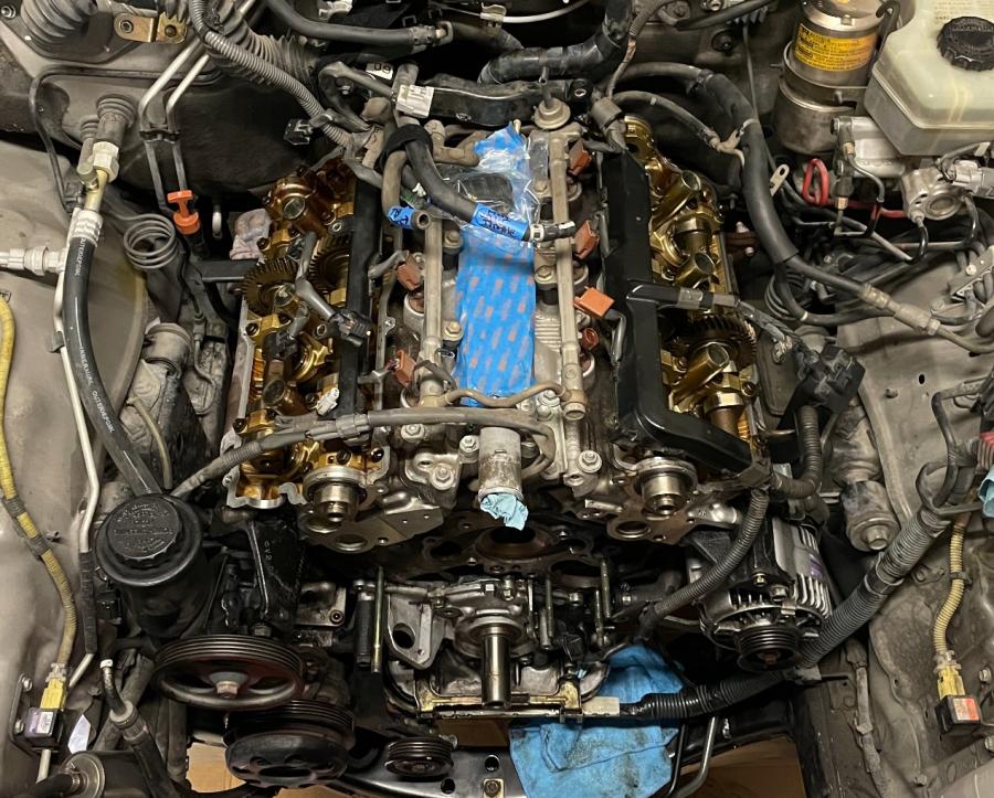

I found a few pictures from back in 2021 when I stripped everything down.

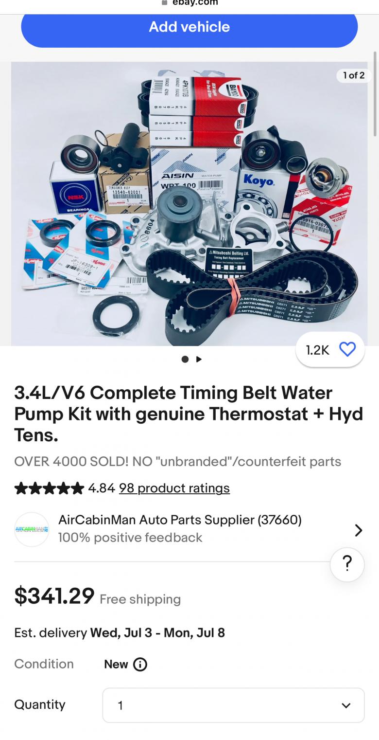

Those are all quality parts IF (giant IF) those are actually what you got. Most, if not all of those parts listed have crappy knock-offs that could have been substituted. What was the source of the kit?
-Charlie
-Charlie
Hey Charlie,
I bought this kit from aircabinman on eBay. (Screenshot of the listing attached)
I think it was recommended on this forum, not to say the parts are guaranteed but I remember several factory looking Toyota box’s.

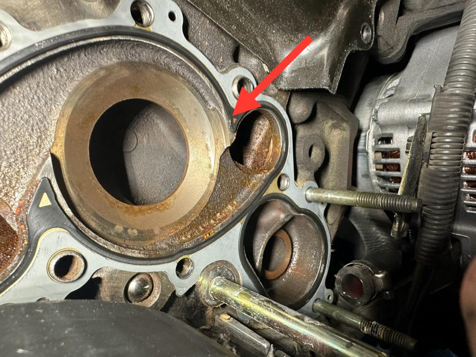

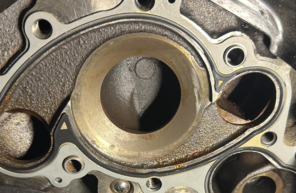

Finally got around to working on this again.
When I pulled off the water pump I noticed a shiny section on the block and was wondering if you guys thought this could be the water pump “blades?” making contact with the block?
I’ll look around for pictures of other people engines here to see if they have similar wear marks.
It's possible that the blades could have contacted the block, does the water pump blades have any damage to them? But I figure if the blads wobble that much you would be able to feel it in the pulley. That could of happened when you were cleaning the gasket surface too.

The water pump blades dont appear to have any damage.
Good thought on previous damage from when I was cleaning that area a few years back. I can't remember if I had scrubbed that down and possibly scuffed it up.

I pulled the bottom timing cover off and the tensioner roller.
There is some bearing noise on this tensioner roller bearing. (or whatever the proper name is for this guy)

I have little expertise but excellent ears, and my ears keep pointing to the water pump. Even before I saw the picture of those scrapes I thought it sounded like those clinky water pump blades.
I could be way off though.
