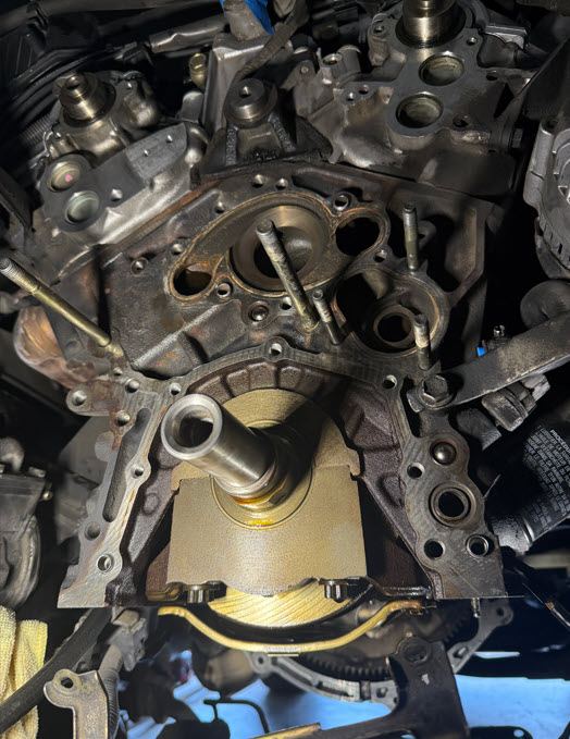

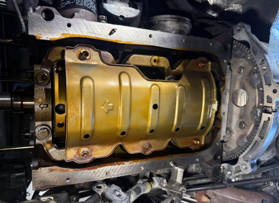

Thank you guys for the help on this one.
Praise God, the noise is gone after a new TB kit and Oil pump.
Replaced the WP, Tensioner roller, and Idler roller several months back with no change.
The noise still seemed to originate from the front of the engines timing components so I grabbed another TB kit from aircabinman on ebay and just replaced everything again.
Replaced the oil pump with a new Aisin unit since the original had 207k miles on it.
Not exactly sure which component was creating the noise but i'm thankful that the engine sounds normal again.
Just in time for 4k miles of road trips in September.
