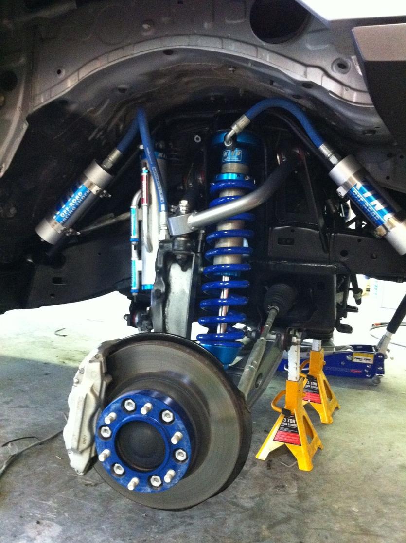

July 12th, 2011 - Installed King Remote Resi Coilovers up front.
July 13th, 2011 - New wheels and tires, 16x8 ATX Mojave 4.5"BS, 275/70R16 BFG All Terrains
- Also installed rear Sway-Away 1.5" Lift Coils & Rear Remote Resi King Shocks

I did remove the OEM Windshield Washer Reservoir to fit the King Remote Resi. I will probably just make a small reservoir out of PVC and stick it in front of the airbox with the washer pumps.

You're right about hardly anyone running Kings in their 4Runners, hard to do research when no one has them. I took a gamble, was gonna either be this, OW again or Icon. Never had King products so figured they were worth a shot and DSM is half hour away, if I ever need anything re-valved.
The ride is a bit smoother than the OW on the road. My OW setup was geared to handle the extra weight of bumpers/skids, etc. Of course after a while I realized I wouldn't really want all that extra weight on my daily driver so the suspension was kinda too stiff for daily driving on So-Cal roads. These have lower spring rates and has the stock valving for the FJ Cruisers. So far its really nice on road, better than the stock setup. Cant wait to see how it handles off road.
