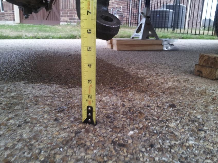

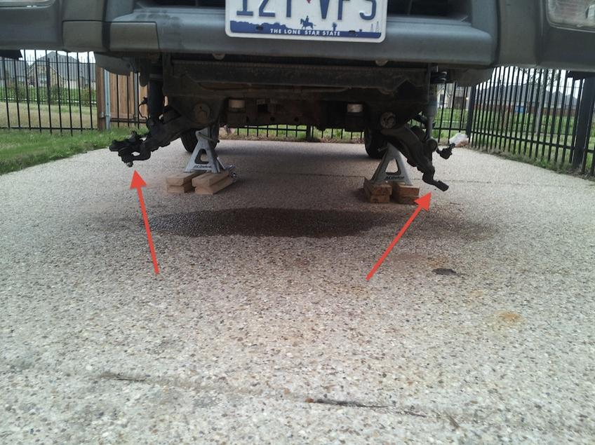

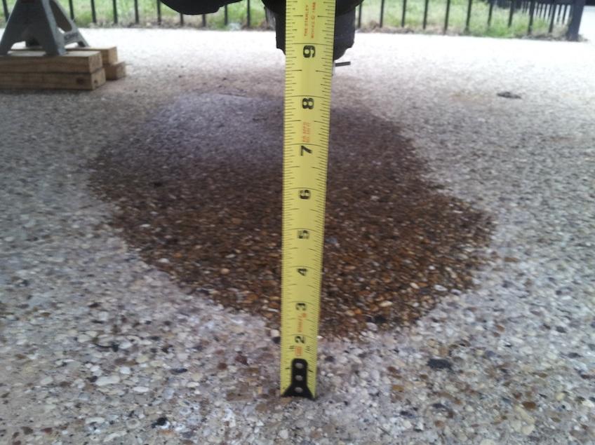

I have another suspension related question for some of you other guys running coilovers as opposed to top plate spacers. Do top plate spacers in combination with coil spacers put more, less, or an equal amount of stress on related suspension components. Am I more of less likely to tear CV boots with space lift vs. coilovers? Going with a bigger tire (33) will not add or reduce stress to the suspension components? Basically I would like to better understand how adjusting different suspension components affects the others. It seems like a domino effect essentially.

The stock 4runner shocks will allow as much droop as the CV will allow. More than that and the CVs will bind and also pull apart. Top out spacers also extend the length of the shock, allowing more droop, also not good.
If the FJC shocks are longer, then they too will allow excessive droop, causing CV damage.
Not following the logic here. Not saying your wrong but not sure how a 1/2 inch top plate will give you 1 inch lift.
This is some info that i had posted on spacers.
The actual spacer thickness is 1/4" (.25"). The Lower control arm is ~14" long (pivot/alignment bolts to the ball joint CL). The shock is inboard by ~6" or 43%. A 1/4" spacer yields .3575 (or 23/64", just shy of 3/8" or .375)
A 3/8" top out spacer will yield .53625, or ~17/32" (just over 1/2 inch)
***Note: Top out spacers will allow the suspension to droop beyond the manufacturers designed length. This excessive droop may cause the CVs to exceed their designed travel causing bind, breakage and pulling apart from over extension.***
Sounds like what you are saying it's the top out spacer causes more damage than coilovers. Probably similar to the damage caused by a coilover or even stock set-up with sway bars disconnected at full droop. Essentially when the down travel is greater than than factory specs it can cause the CV to bind among other issues. Whether this is caused by top plate spacers or disconnected sway bars at full droop the result is basically the same?
Top out spacers == Longer shock (Like the FJC shock).
The sway bars being disconnected wont cause any extra damage. The limiting entity is the shock in our trucks. That is why it is important to have the correct length shock.
