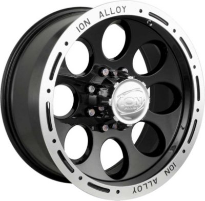

Looking at some new wheels for "Project Banshee" (officially named her)
Wondering if these will fit or if they will give me any issues with rubbing.
Any problems or Issues you guys see using these? 2" lift currently
running 31in tires thinking of going 33 with the new wheels.
ion1745883b_1
Item Specifications:
-27 mm offset
Item Details:
2500 lbs. load capacity
Aluminum alloy
Includes center cap
Black
Series: ION Alloy Wheels Style 174
Material: Aluminum alloy
Design: Hole/slot
Color Finish: Black
Fitnotes: 6x139.7mm / 6x5.5 in. Bolt Pattern,

If you're at stock height, 33s are probably ok for scooting around town but will rub on the rear of the front fenders if you stuff the wheel.
The offset doesn't say anything if we don't know the width of the wheel - what's the backspace on these? What backspace is on the wheels you have now, and how much room do you have?
