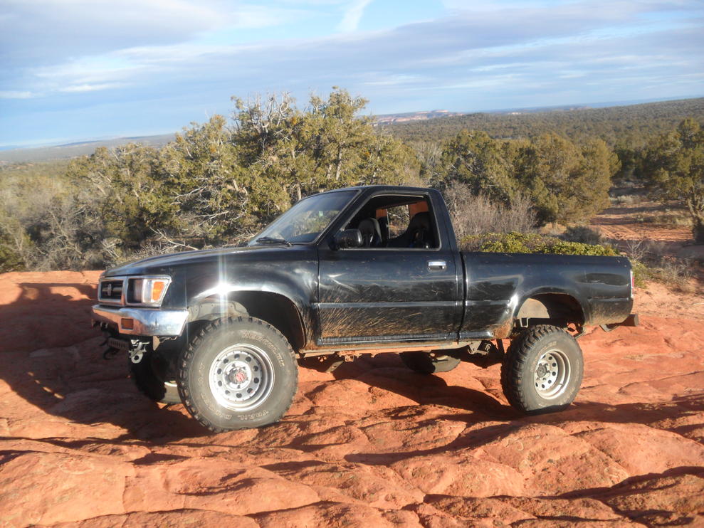

I personally would stay away from BJ spacers. Back when I had my 3rd gen pickup I thought about everything from bj spacers to full on long travel. Because it was my daily driver I needed it to be reliable. So I ended up just upgrading the shocks to billies. That truck went through hell, I took it on trails with the local jeep club, jumped it all the time, took it through sand woops, hit 2 trees, a cattlegard, backed into the garage and shot the poor thing.
I would do shocks, 31's and leave it at that.
here is my old truck for reference.
