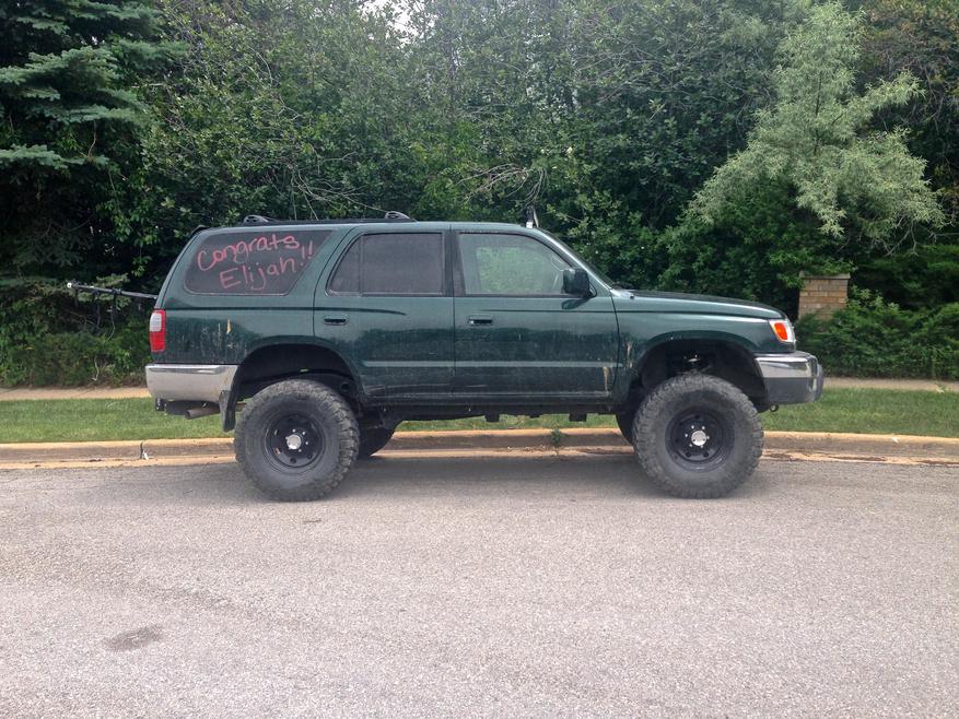

I've have also been camping a lot lately and I have loaded the rear with a lot of weight and a think that when you push the rear end down it also makes the front raise up making it sit higher. Does that sound like a possibility? I drove ~600 miles with the rear loaded. I'm also planning on putting a 12,000lb winch on the front which might help lower/weigh it down.

Holy shit how much lift do you have? No body lift and it looks like you have like 5" of lift. What's your fender to center of hub measurement? Suspension isn't cheap, either fork out the dough or lower the whole thing or just say **** it and keep replacing stuff.
Ill get measurements tomorrow but I have FZJ80 coils in the rear and they are anywhere from 3.5-5" of lift. I made the mistake of not measuring before the lift so I don't know what its gained. Sonoran Steel's website said that the rear will be 1" higher than the front. I measure from fender to tire and the rear was a 10" gap and I adjusted the front to a 9" gap so that the rear was 1" higher like they said.

Measuring from the center of the hub to the fender is the only accurate way to measure lift height.
And that does look like a lot of lift in the front. Im betting you have next to no downward wheel travel and your suspension is constantly topping out. With stock LCA's, 2.5" is the max amount of lift that you should run.

Your front is wayyyyy too high... I imagine you've got some 9 wraps or something in the back to get that much lift.
I think it's pretty widely accepted that you want to keep the front hub to fender measurement under 23". I bet you're closer to 25".
What will be effected greater by the lift - the ball joints or the Cv axles? I measured from hub to fender and subtracted 1" to account for the body lift and the rear is ~24.5" and the front ~24". So I'm 1" over the 23" that you recommend.

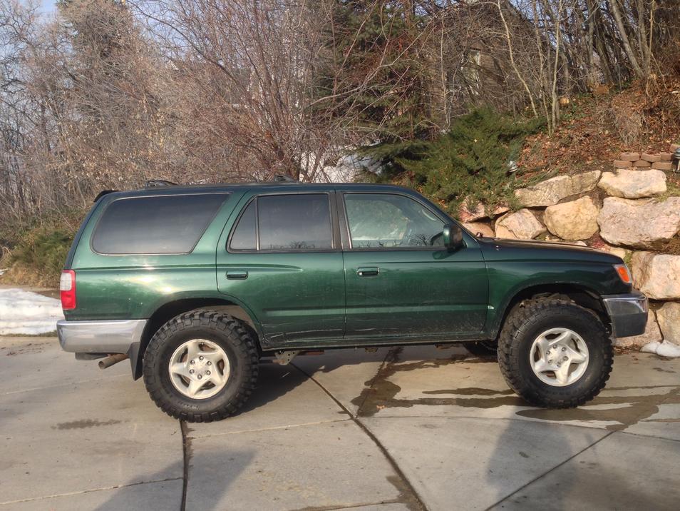

Here is what it originally looked like with no lift, I did have the 33" tires on though.

Ok so right now I have replaced the LBJ and Tie rods with Tacoma parts, I just installed the SPC light racing UCA's and the problem I have right now is the CV boots tearing. Who makes CV boots? I know All Pro makes and inner boot but my outers are the ones tearing.
