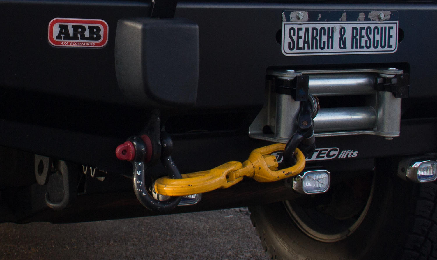

Question: how does everyone keep the cable on their winch spooled evenly? i read it's important, but even under load i can't seam to keep it even...?
isn't she purdy! :naughty:
nice rig. yeah keeping the line spooled evenly is important, that way you dont kink the line or damage it. its best to spool it in under a load, ive always used a pry-bar to help guide the line and set it where i want. you might want to invest in some shackles, for you bumper, and then use some 3/4" ballcock washers(you can find them at any plumbing or ace hardwear store(home depot and lowes didnt have them) to keep the shackles from rattling around on your bumper. also if you want to put your license plate over the opening for your winch cable(i recommend this -saves the cable from getting road spray and grime all over it), you can buy those maglight wall mount clips... they are the perfect size for the rollers on the fairlead.

that's a good idea about keeping the fairleed clean and an actual function for the front plate!
i do have 2 shackles and i used one to attach to the tow strap which lasso's the tree stumps, i just don't like things hanging from the bumper.... i was trying to feed the cable onto the winch through my gloves as i wound it up, but it didn't help much....
So as "the kid" recommended, the D-Cell Mag light mounts for the front plate worked great! Hold securely and easily removable for access to winch!
