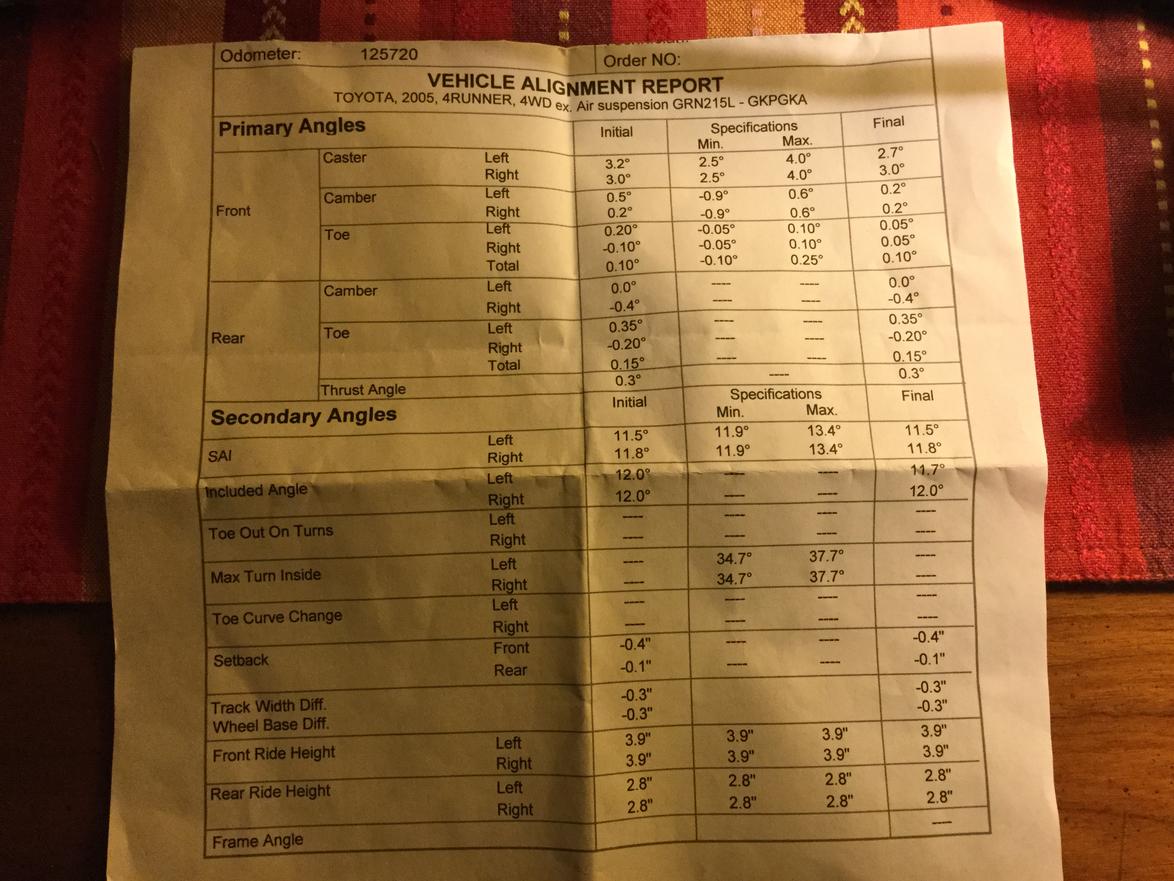

I decreased my pressure for my drive home to 36 psi. I feel like the ride is greatly improved. Still have touchy steering, but the overall drive quality has improved. I'm not tracking around nearly as much anymore. Since I've been riding at 45 psi, it does feel really squishy and soft now but not to the point that my handling feels compromised; just different. Heres the alignment print out:

I'm only lifted 3/2 with lots of caster on LR UCA's and I'm getting a wagging feeling in the rear of mine that forces the front end to hunt back and forth. New passenger wheel bearing, LCA bushings, balljoints, tie rod inner and outers, front sway links, extended rear sway links, front and rear sway bushings, the whole deal and while the ride has greatly improved this issue has cropped up and I can't align it away. I've decided to get an adjustable panhard bar since my rear axle is shifted over ~3/8" and not tracking straight is the only thing I can come up with (and can measure that is wrong) so I'll keep you posted if that helps.
