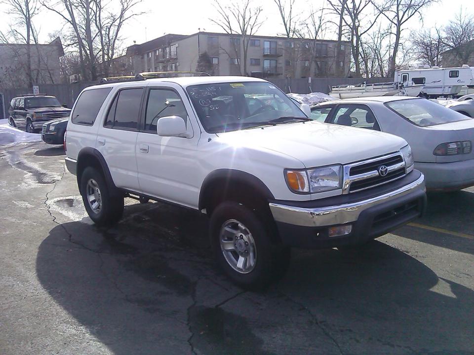

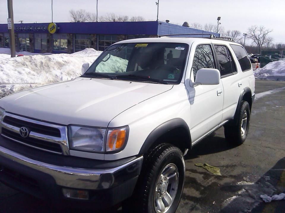

It's new to me, at least! I am driving a 1999 Toyota 4Runner SR5. It has a 3.4 L V6, automatic. I am only 17, this is my first vehicle. I LOVE IT! The four wheel drive seriously can't be beat. I just wanted to see if anyone could help with me with the small problems:

Two photos of my ride are attached.
