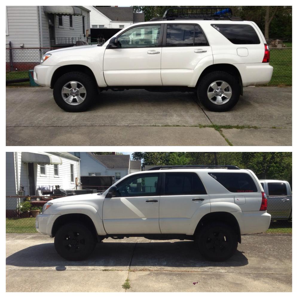

Top picture is with the Daystar lift, bottom is the 5100/885/ToyTec Supercoil lift. I netted about 1.25" more lift all the way around and have much better ride quality
