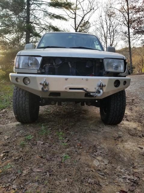

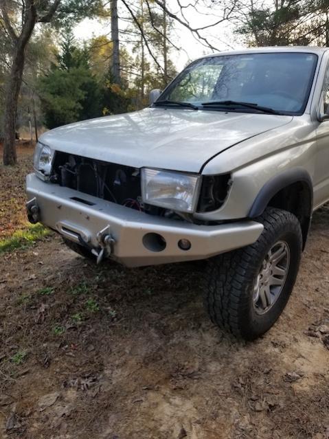

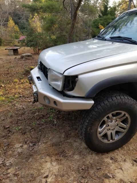

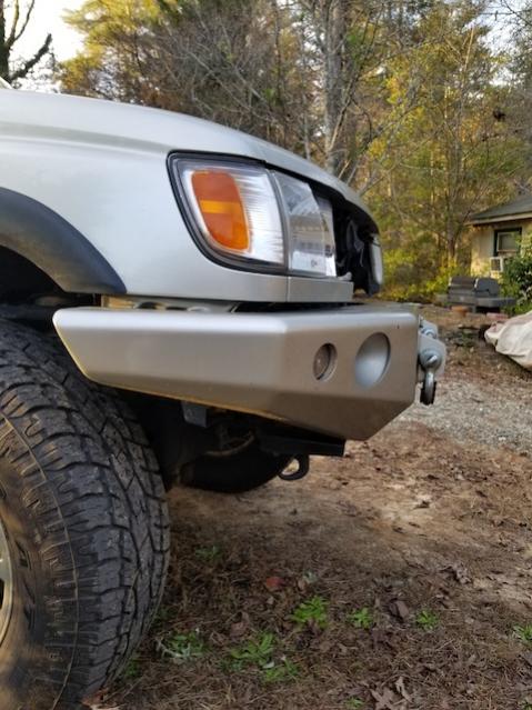

Howdy.
I had a little traffic incident yesterday in my mostly stock 99 T4R Limted and it pushed the bumper around more than I expected. Once I cooled off a little, I wondered how a plate bumper would handle a similar incident.
The short version is some jerk brake-checked me all the way to a full-stop and I couldn't stop in time. Bumper to bumper contact yielded my bumper getting pushed up and in on the passenger side and his getting scuffed from mine.
I don't yet know if the frame horn is bent, but I'm assuming zero to nominal deflection of the frame horn considering how little my bumper moved.
I'm curious if the consensus/experience is that the stronger bumper just damages the frame more, or if it takes the force and shares it with the other vehicle more. (I'm much less concerned about the other person's car than mine.)
Great forum here. I look forward to everyone's thoughts.
Here's my truck.
and before yesterday

I had an all pro tube bumper on my Tacoma and I rear ended a sedan maybe 6-7years ago. Car was totaled, my truck literally had 0 damage.
You'll want the ARB deluxe as it has crash cans.
Also, as a rule of thumb, if you have to hit something and have no choice, aim for the Civic. Small weak cars become your crumple zone.
This was after a deer strike at 70 mph with a Shrockworks bumper. The deer was roughly 200-210 pounds. I hit him pretty much centered. Luckily, the deer went low and to the side and I ended up going over him partially, otherwise I am sure that it would have caused enough body damage to total it. No frame damage, except for the end caps that I had welded on the ends of the frame rails. Had I not done a shitty weld job, they probably would have been fine.
