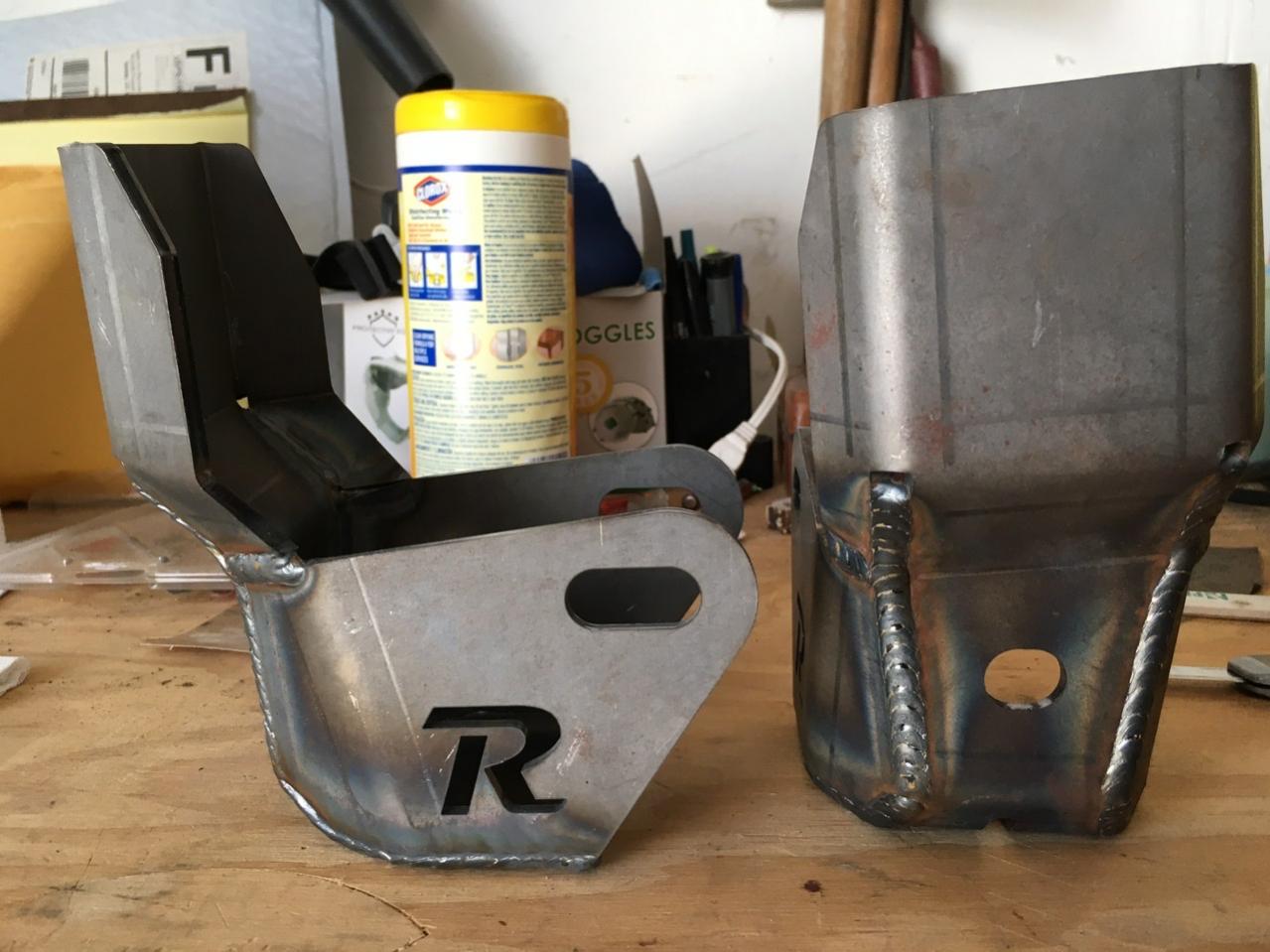

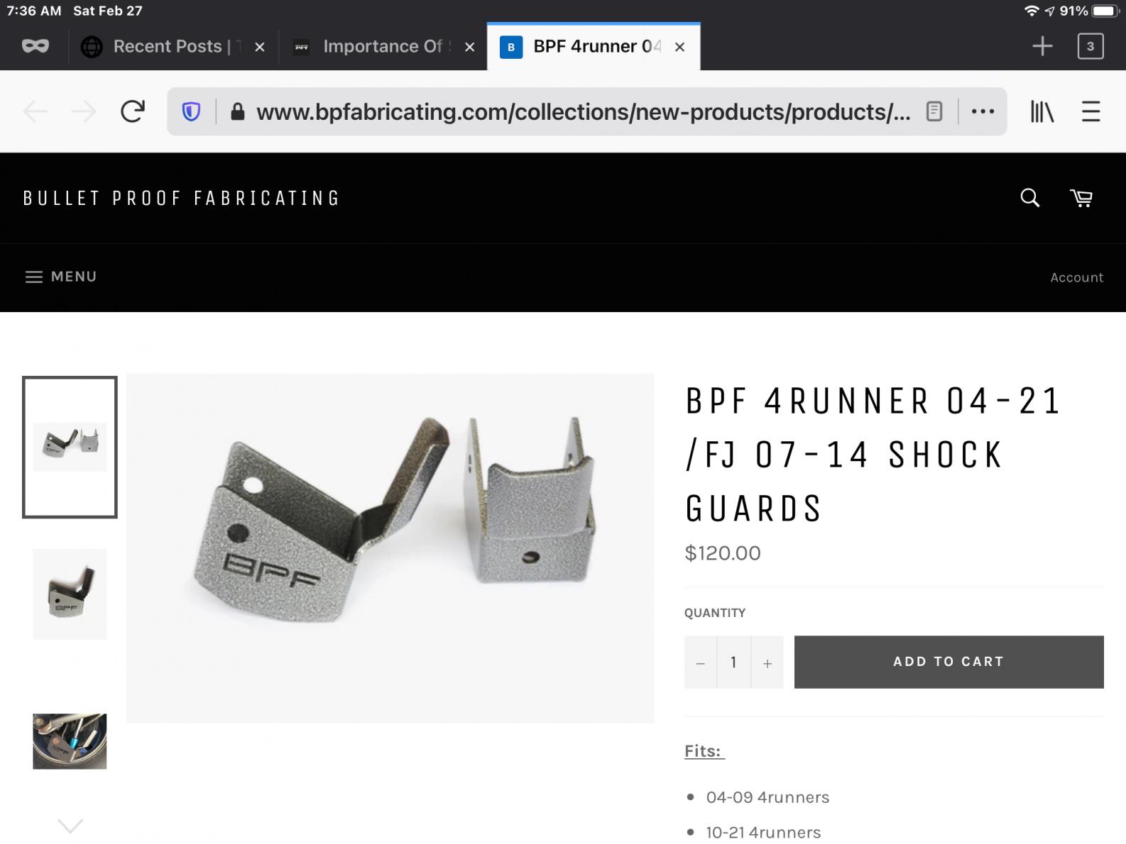

If you do happen to hit a rock, it looks like the BPF would bend before the Rago. This is just my opinion by looking at them, the Rago has the side stiffening for lack of a better word.
His comment on Rago being a copy of BPF was probably based on the first pic in the thread, as installed on a truck. That *does* look similar. Probably a first Gen development model that they shouldn’t have included on their website, it’s confusing. The other pics on the website definitely look beefier.
Different tools for different jobs. I've had basic rubber boots ziptied to the rear shocks to prevent rocks and such from pitting the rear shock shaft. However these boots only cover the shaft. These Rago Shock guards cover the lower shock mount. Which is an area that will hit rocks. These lower shock mounts cost $50 each and cost roughly $120 in labor to replace. At least the King Shock ones do.
A point mentioned earlier: no shock shaft would hold up to an impact that would be large enough to bend one of these guards back enough to contact the shaft.
These are also designed with the sides to provide some stiffening of the front of the guard to reduce the ability for it to bend backwards.
