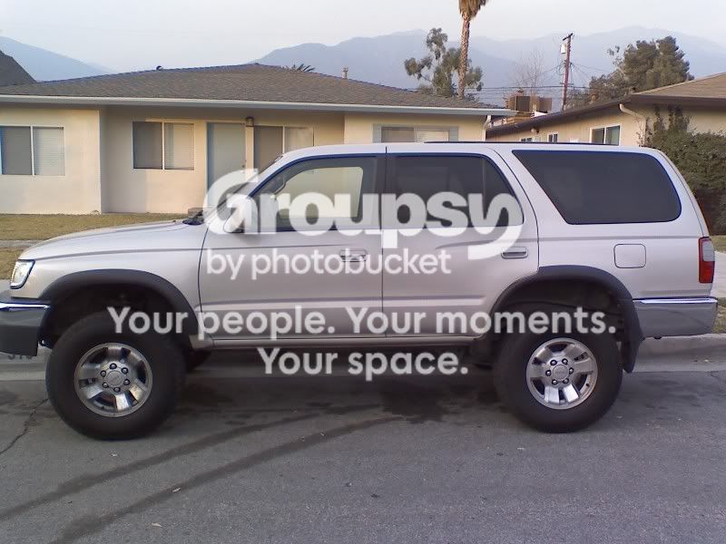

After taking the running boards off, wouldnt it look bad with the stock fender flares?, and if you removed the fender flares arent there bolt holes? Im taking mine off and I dont want it to look stupid with stock fender flares, or with holes where the fender flares used to be. Pretty much asking if anyone has removed there flares and running boards?
I removed mine, but I have the limited flares and they look fine as they come all the way to the bottom of the truck. I have seen trucks like yours with the black sr5 flares and running boards removed and I personally don't think it looks bad at all. Also, I'm 90% sure that your flares do not have holes in the fenders behind them. Only the Limited style flares and maybe the Sport style flares.
edit: Here is a picture of 4rnr4me's 4Runner. As you can see he has the running boards removed with the same flares you have.
1229071611b.jpg~original
I have since put the mudguards on the front, and I'm going to put the door sills back on, but they have metal clips that will scratch the doors if you dont put some thick stickies on the door first...
but even without, it still looks OK
and NO, they do not have holes in the fenders behind them...the holes are all on the bottom where u cant see them :D
