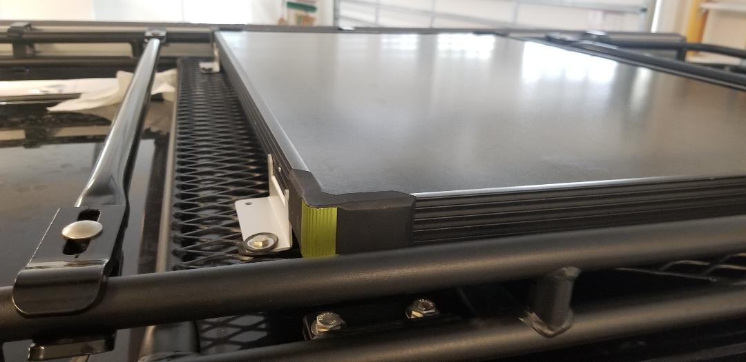

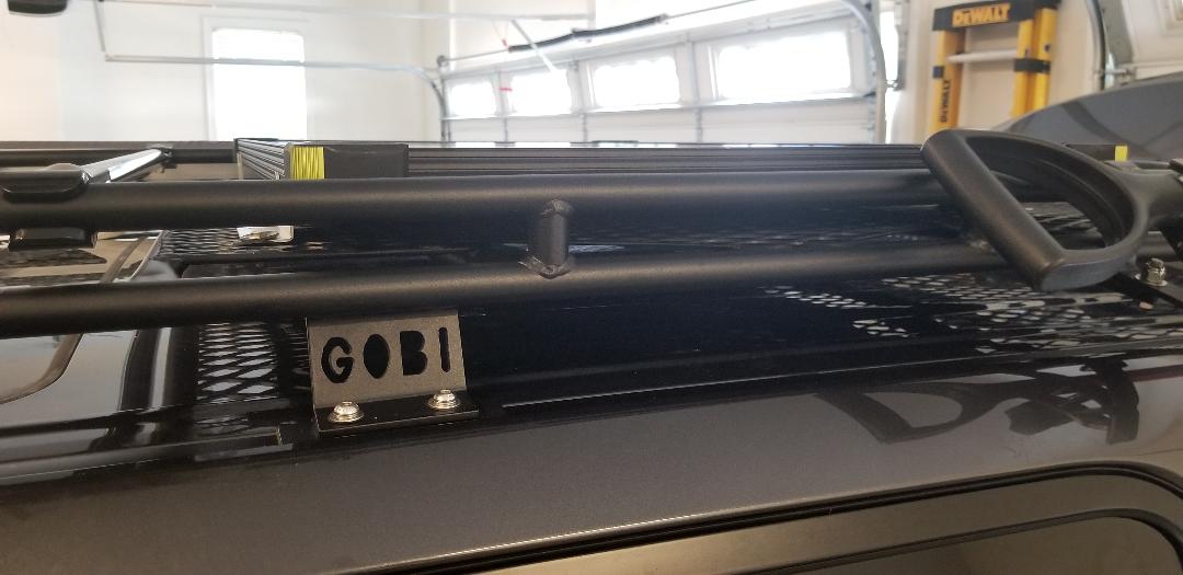

Future plans...I already bought new solar panel mounts off of amazon so they are lower profile. I initially used the goal zero mounts but were too tall for daily use. Biggest thing I need to figure out how to wire the solar panel more permanently. I lowered the back window a smidge and the wire came in that way which worked great and I could still open the hatch.

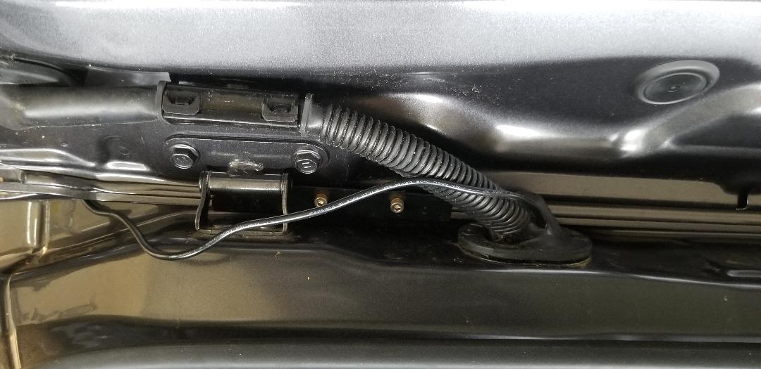

I did see the new video by @swellrunner and I had actually messaged him a week or two ago and he had mentioned coming in through the grommet. Still not 100% set on that but need to figure out something. I don't leave my fridge in all the time, only for trips and as needed.

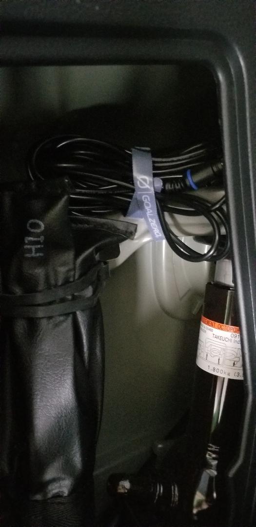

Ended up working on it today. Updated the brackets to the amazon aluminum generic ones, MUCH better, much lower profile. Also ended up modifying the wiring and cutting the grommet to bring the wire inside the cab. I brought the wire from the panel into the grommet then hooked it up to a 15 foot extension. Brought the extension down the back pillar inside the plastic trim and then left the extra in the jack storage location. That way if I used the yeti I can just open the panel a little and bring the wire to plug in the yeti.
I had tried running the wire just inbetween the hatch and the rubber seal but washed the truck and noticed water coming in, so that wasnt going to work.
