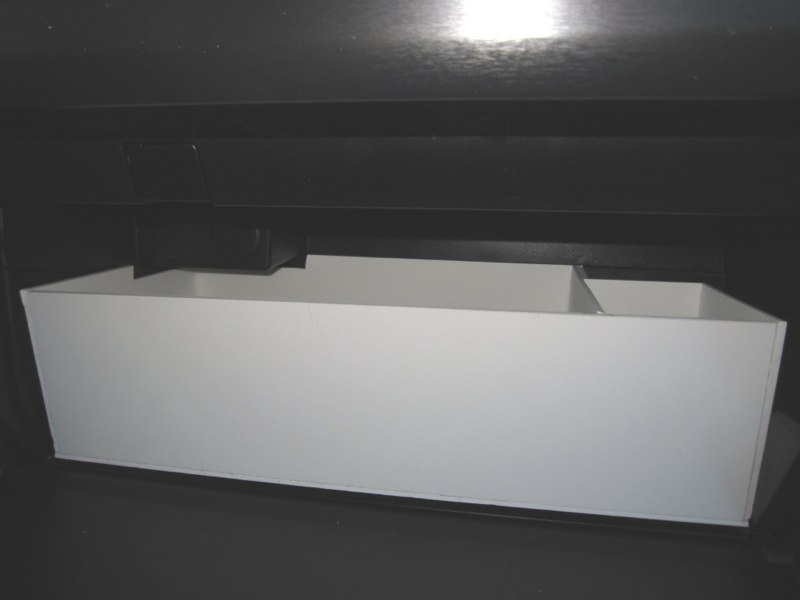

Ok, so this isn't a major build/upgrade, and probably not even an issue for most people. :)
But I don't like the way the entire front of the glove compartment opens up. I tend to keep a lot of stuff in there and don't want it all spilling out when I open it:

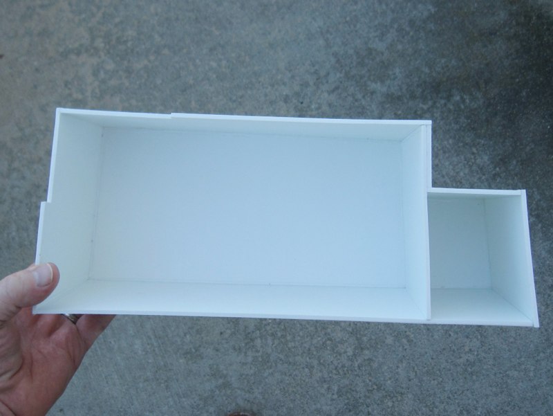

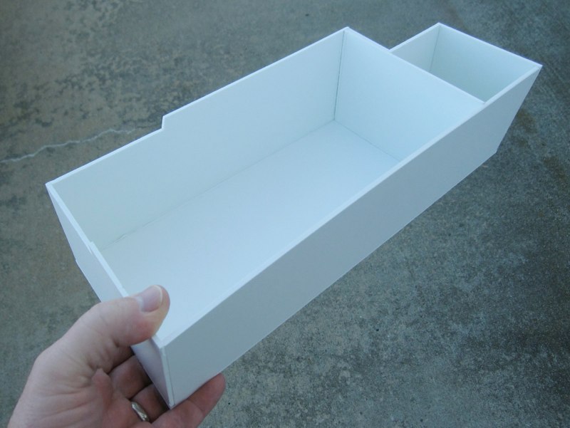

So… I built a custom fitted tray that slides in and can hold a lot of small items. I made it out of 4mm sheets of Sintra PVC foam board. This material is sturdy yet easy to work with. The glove compartment interior is an odd shape with a couple of protrusions so it took a little trail and error to get the fit right:

Cool, looks good. Smart move on getting white, makes it easy to see in there. Black would make it harder to see little bits floating around on the bottom.

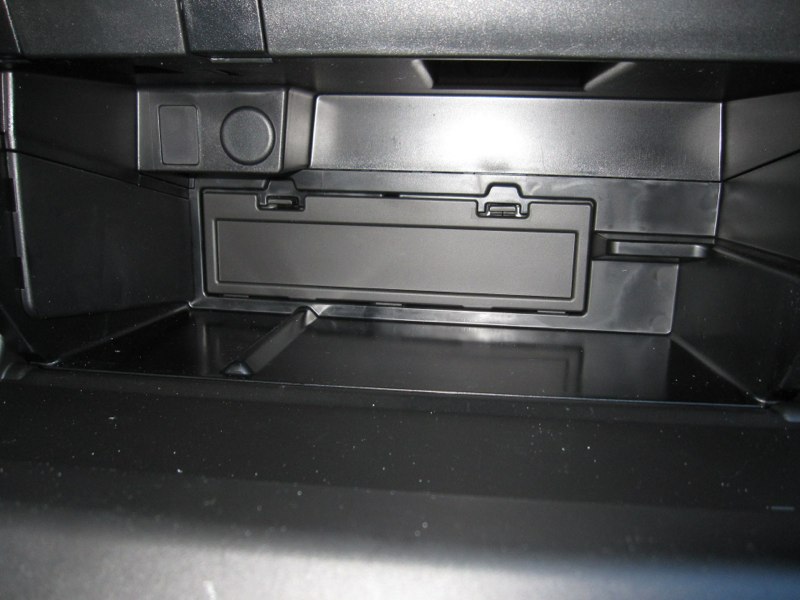

- Is the back panel for a cabin air filter?
- In the upper left corner it looks like optional power outlet in the round opening. What option goes in the rectangular opening? USB ports?
- Did a factory shelf or anything else need to be removed to create such a large opening?
Interesting!
1) cabin air filter, yeah.
2) some model years had usb ports. 2015s had nothing. assume the same for 2016. simply a blank plug that can be removed.
3) nope. that lovely cavern comes to us just like that.
