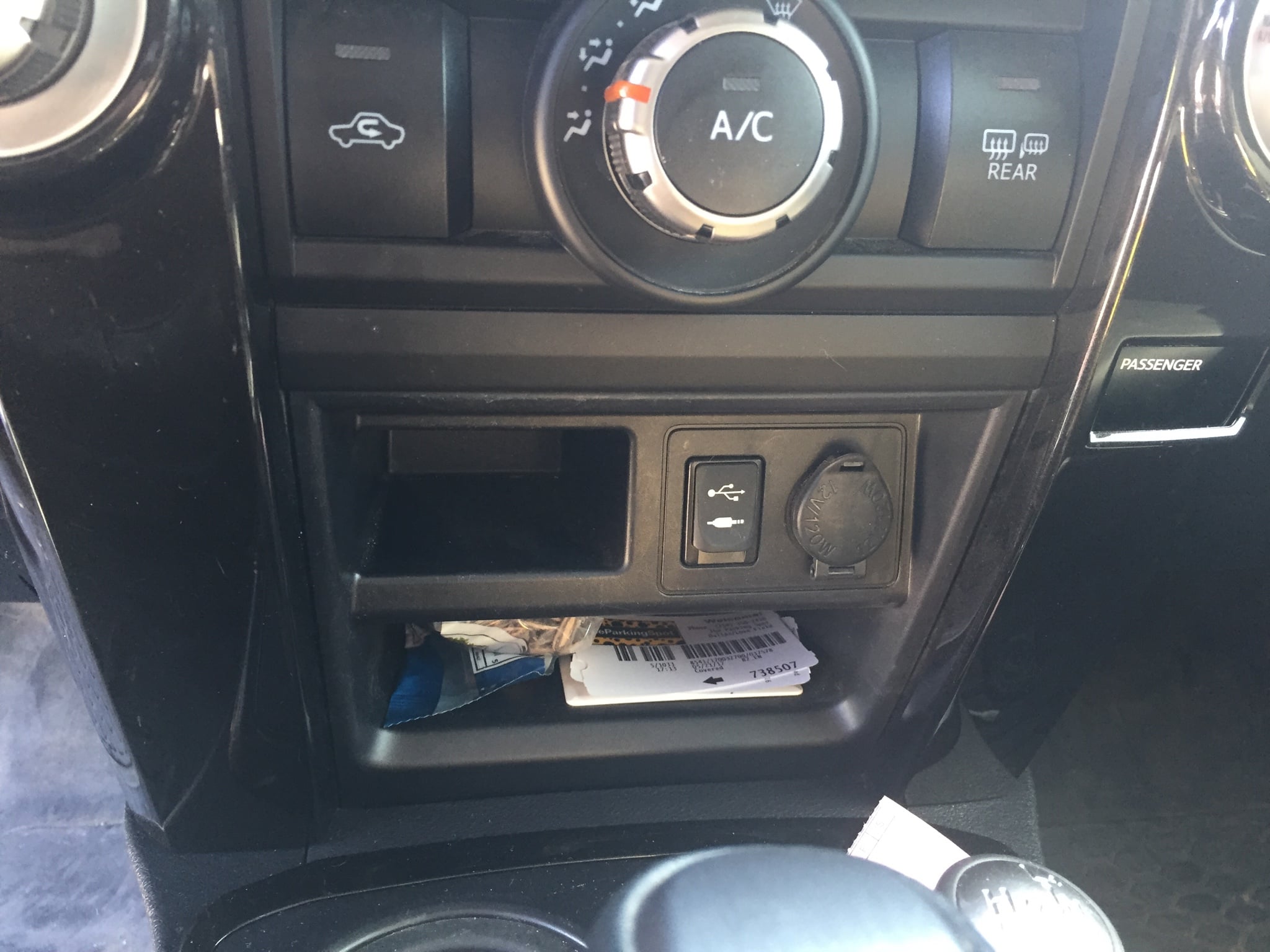

I've been searching for what feels like weeks, and haven't seen anyone do what I'm hoping to do when I get around to installing a CB radio in my truck.
Figured I would pose the question and someone would know from taking the dash apart for other mods (@antman?).
Would a CB fit depth-wise in the area (if cut/removed) where the half-width storage cubby and AUX/12V outlet is in the attached pic?
I thought most CB'rs went the way of single side band. But if I were doing it, I would look for one with remote tuning and controls. That way the radio could be anywhere like under a seat; thus removing the need to cut up the dash.
Could, but you could have trouble trimming the trims properly.
The center console has good space too. I'd go with the split Cobra unit. I had one and they're so easy to "install".

Why CB? Friends have CB, places I hunt have CB bases nearby (even where cell service is spotty), and history with CB use. I'd like to eventually go HAM, I think, but want to start simple before diving headfirst into all the HAM licensing/equipment runs my life.
For the record, I'm leaning towards the Uniden 520XL Pro. My BIL is a sheriff's deputy and uses it all the time. That, or the Cobra 29 LX, but I like the compact nature of the Uniden for now.
Taking the dash apart is a piece of cake. You need brute force and a phillips screwdriver (video in my build thread on page 1), it takes less than a minute. Find a radio with a shallow box and use that measurement. Cutting into the cubby is fairly easy. I used a dremel and a box cutter. I plastic soldered my switches into the cubby so they would stay put. OR.... Another option is the console. I have an external speaker so no need to have the console open while using the radio, set it and forget it. I mounted the radio on the rear wall of the cubby with heavy duty velcro. It doesn't move and fits perfect, with plenty of space left for storage. Also it's easy to run wire into the cubby, just remove the console and drill a hole in the bottom.

This thread has more ideas, including my dash mounted Midland 75-822.
BTW my truck stop CB shop recommended the Midland over the Cobra 75 because they could tweek it to get it at max legal power output and could not do that with the Cobra. As with many CBS they can be well below max legal power out of the box.
http://www.toyota-4runner.org/5th-gen-t4rs/211968-cb-radio-suggestions-8.html
Edit add: If you go in the dash you will likely be covering the CB speaker, which could degrade clarity.
