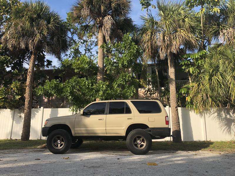

I added a picture of the truck so the thread isn’t too boring lol
