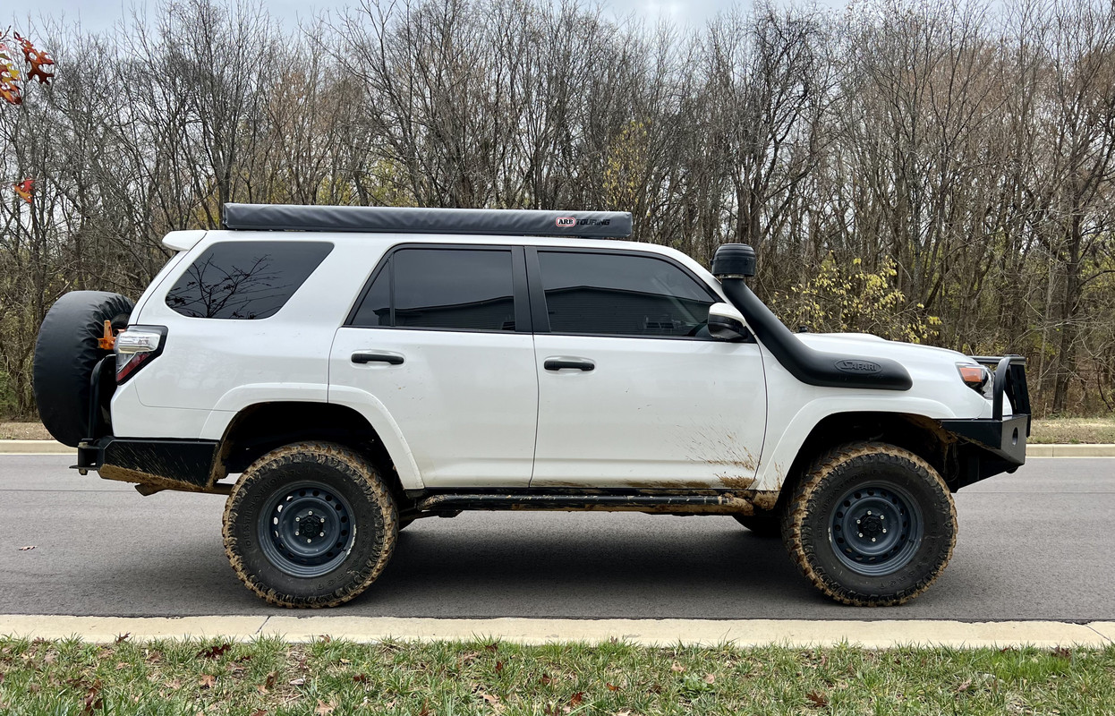

I’m about a hour east of you and I’m averaging 17mpg with KO2 Tires. It bumps up to 17.5 in the summer.
Every time I fill up the tank I reset the “A” mileage odometer. Then when I fill up my tank I divide the miles by the number of gallons I just put in and that gives me a more accurate number on how many mpg I’m really getting. You can use this to compare what the computer is telling you. At least you’ll be able to rule out if the car computer is the problem or not.
