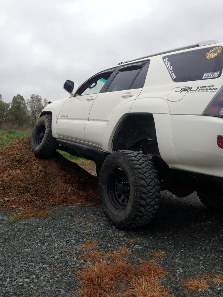

this is pretty much maxed out rear flex i may be able to get another inch out of it if i switch to adjustable link arms:

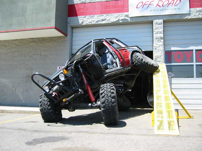

Easy. You just need a reaaaaaaalllllly long travel suspension swap :wow:
I like how you can see the Toyota emblem of the vehicle behind it, right THROUGH the rear suspension
