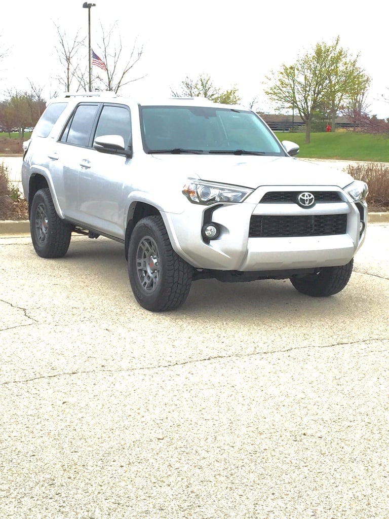

Safely install? I can tell you first hand that when I had my 285/70/17 duratracs on my TRD Pro wheels for about 20,000 miles I had zero issues on or off road and did not experience any issues with abnormal tire wearing. This is just my experience with my driving habits and rotation every 3k mi. I currently have 305/70/17 Goodyear MTR's on my TRD Pro's, but only have about 3400 miles on them so far. I don't think the discount tire guys would have installed them if there were any safety issues (I could be wrong about that haha). I will definitely keep anyone who is curious up to date with posts on how my experience goes putting this size of tire with 7" rim. If it starts to hurt my tires or somehow becomes a safety hazard (highly unlikely) I will probably put mine up for sale and grab some FN wheels. :tea:
My TRD Pro rims are fine with Cooper AT3's, stock size.
Yes, I just did it on my 2011 Trail...no issues.
