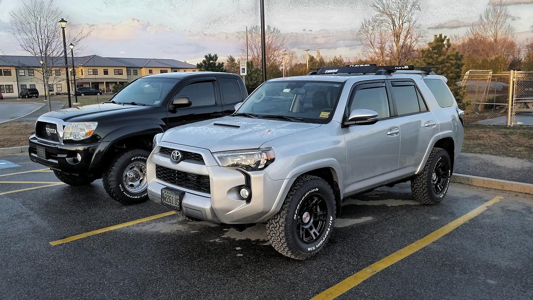

Absolutely. Here are some photos from [MENTION=105384]TOYOTA 09[/MENTION] and also a few that my customer's sent me (a big thank you to everyone who has posted or sent me photos):
Posts # 627,628,629.
Thanks Bill. I reposted the photos and added a few more here too. :)
Thanks for the pics Dustin, I have been following along with the thread. I was just wondering if you had taken any "promo" type T4R pics we hadn't seen.
Toyota 09 for the win, I searched and found his BFG's were 285 size. I think my 285 Duratracs and BOSS lift would look great with those rims but now to decide on the color!

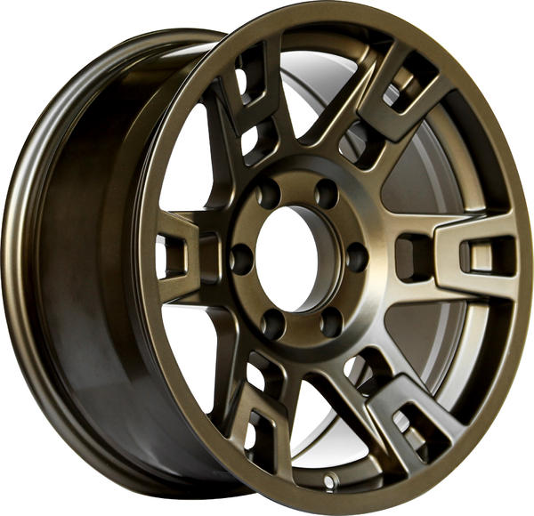

Here are the specs of our new wheel:
FN Wheels Model Name: ƒ(x) Pro
Diameter: 17"
Width: 8"
Offset: 0mm
Backspacing: 4.5"
Load rating: 955KG (2,100lbs+)
Weight: 23.88lbs (approximate) (vs. 27lbs +/- for the OE wheel)
Certification: JWL-T, VIA, SAE J-2530, DOT approved
Colors: Matte gunmetal*, dark gloss gunmetal, matte black* and matte bronze - *Matte gunmetal available June 2015, matte black currently sold out until July 2015.
Toyota specifics: 106mm hub centric for Toyota hubs, lug holes drilled for 12mm Toyota wheel studs for a snug fit, and center machined to accept flat snap-in OE center cap* (not the raised OE Pro cap). *OEM center cap not included. Plain center cap will be included with the wheels.
Price: $699 + shipping for a set of four.
We sought to answer the demand from 4Runner owners / T4R.org members with this wheel. Many of us feel that the OE wheel missed the ball so to speak with the 7" wheel width. There is no debate as to whether or not a 7" wide wheel falls into the tire manufacturers' approved rim width range for the popular 285/70R17 tire size (it does not). Some will debate whether or not it is still safe, but at the end of the day if it's not in the tire manufacturers' approved specifications you may find your tires wearing prematurely or unevenly, and if so, the tire manufacturer is under no obligation to warranty your tires. This is also not to mention potential safety concerns with pinching a wider tire on too narrow of a wheel.
Consequently, we spent almost a year talking with 4Runner owners about this wheel. We discussed what improvements should made, and then we spent many hours working with our engineering and design time, testing, casting multiple samples, testing again, certifying the wheels, and finally coming up with the wheel you see here.
The specs of the FN Wheels ƒ(x) Pro are perfect for lifted 4Runners with larger tires (especially the super popular 285/70R17 size), but the ƒ(x) Pros will also work great with OEM suspension and OE sized 265/70R17 (or 265/65R17 tires for previous generation 4Runners). The quality of the wheels is consistent with FN Wheels' commitment to offering a premium product in the specs, colors, finishes, etc. that our customers want.

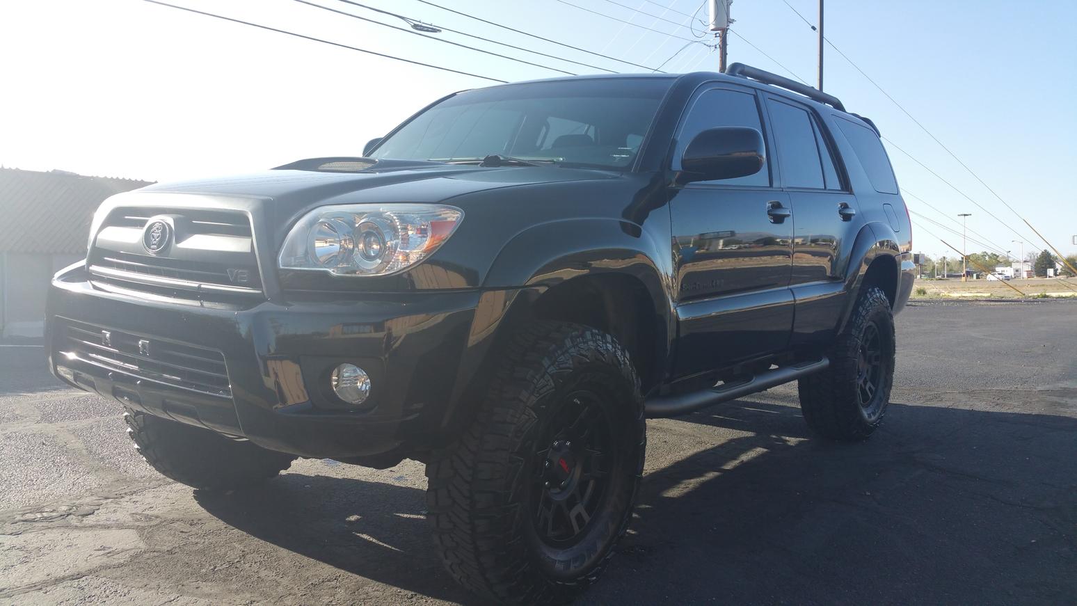

06 T4R V8 SE 65K Goodyear MTR 305/70/17. TRD Pro rims. Afe intake. Boss 3 inch lift. Toytec 1 inch body lift. LR UCA's. Body mount chop. Black Ops Custom emblem replaces the stock Toyota Emblem. Plasti dipped grill and badges all the way around. Page 250 on the Lift and Tire central thread has a pic of the other side.

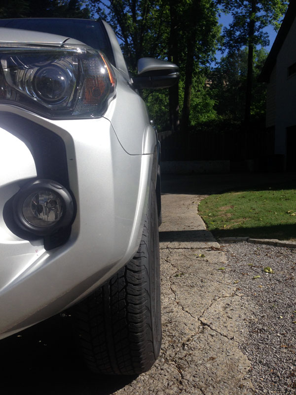

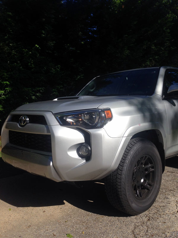

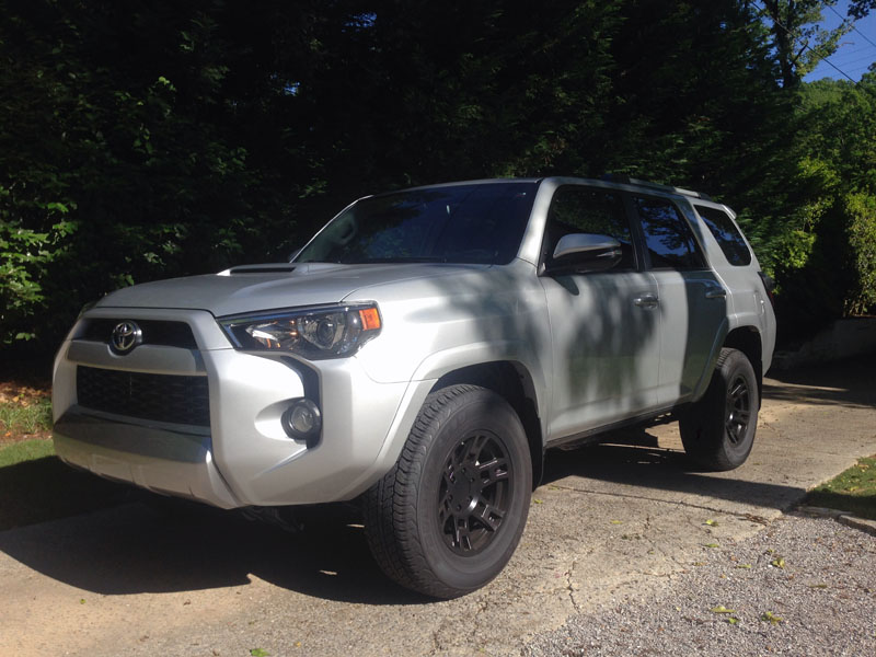

Well I got mine in today. Just gotta work with a friend to get a good deal on some rubber. I was thinking of KO2 in either a 275 or 285.
Will I need to do any modding minor or major to fit the 285s. I have had contradicting evidence on many places on this forum. Some say yes and only some minor rubbing on mud flaps. Others have said I will need an inner fender mod and perhaps even the body mount mod.
Thanks for the help in advance.

I have a 3 inch toytec lift and radflo rear coils, same wheels with BFG KO2 in 285 and no rub, i removed the mud flaps just in case but after turning i don't think it'll rub. I also have light racing UCA.
And no issues with the tires on the 7" wheel? My guy is trying to say I could have wear issues but I've told him all you guys say I won't. Lol
