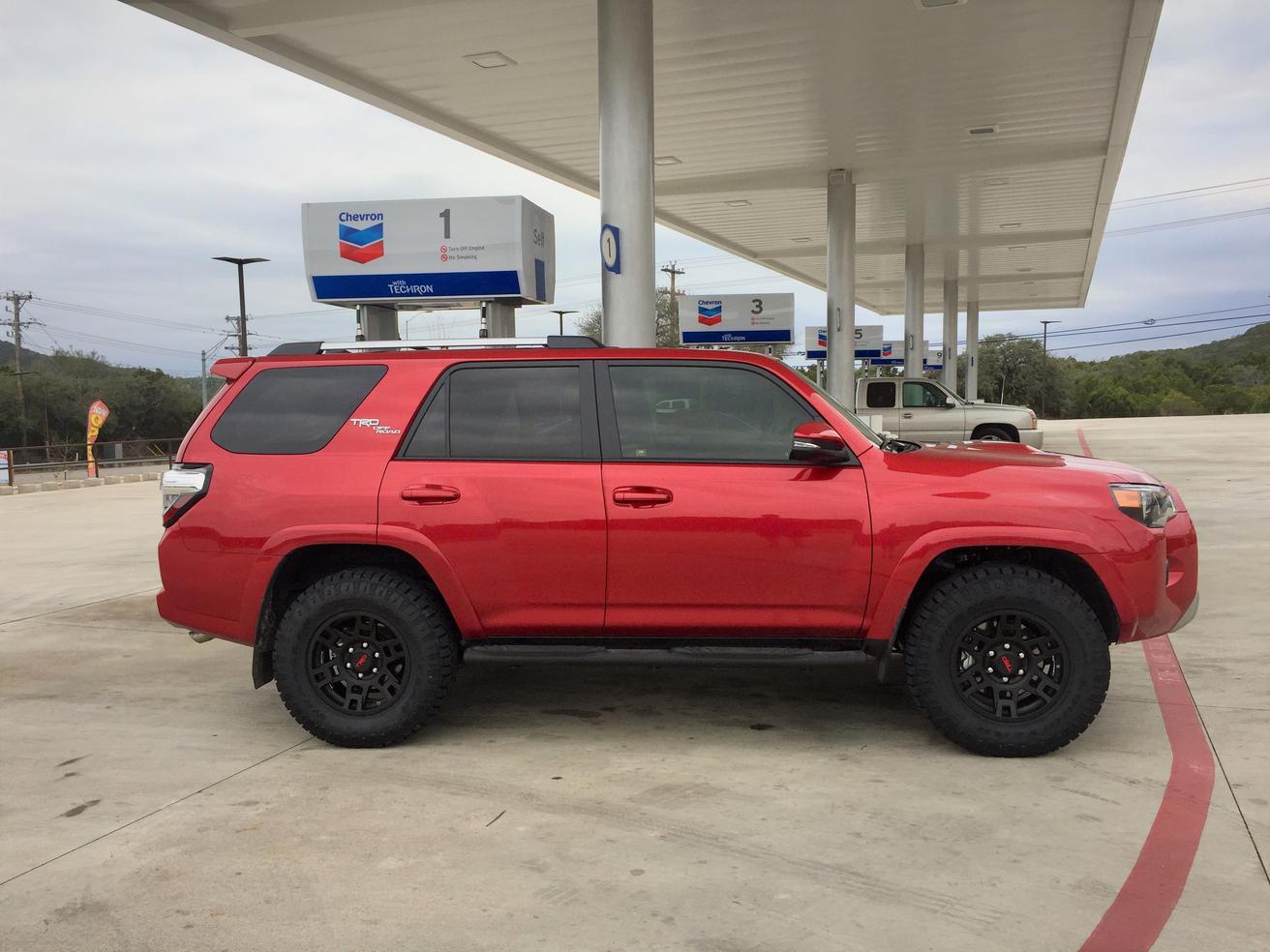

No issues on my 2018 TRD Off Road with 265/70/17 on TRD wheels.
