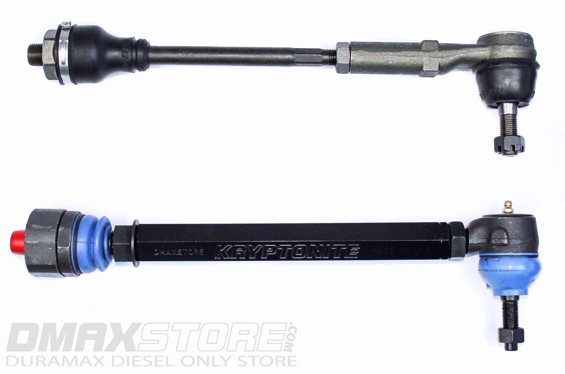

Something like this
It's worth considering what the NEXT weakest part is in the system if you upgrade your tie rods. Right now, if your front wheel takes a large lateral hit, the tie rod is the weak link, right? But it's pretty damn easy to replace, and cheap.
If your tie rod is bulletproof, SOMETHING has to fail eventually. What if you snap the arm off the knuckle on the trail? That's significantly harder to fix.
Oftentimes, things like tie rods are intended to be "mechanical fuses" for those sorts of inevitable situations. When I used to design racecar suspensions, we'd intentionally leave the tie rod as the weakest link since it was MUCH easier and cheaper to replace in the field than an upright or control arm.

That is a good way of looking at it, since noone else has come up with options ill go with that answer.. Thanks!
