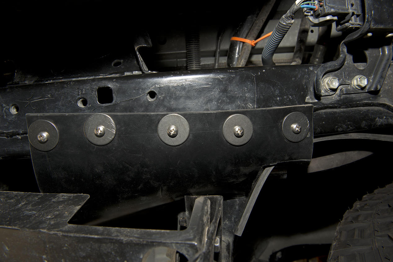

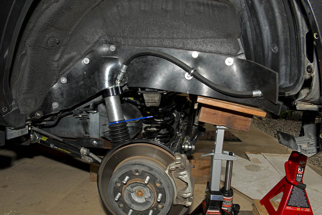

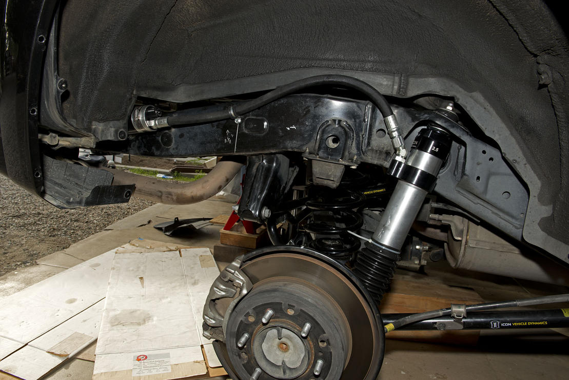

I've made these for the back wheel wells to protect the ICON remote reservoir and close the gap between the body and the frame that's wide open in the stock wheel well. I used 1/4" rubber sheeting I found in a 4 foot square piece on Amazon.
The back wheel wells were fairly easy. The front will be a bit harder to cut to fit. Here are photos of the liner. The first photo is the finished liner, in two pieces sharing a screw above the shock. The 3rd photo shows the OEM gap that occurs between the body and frame inside the wheel well. I pre-drilled and screwed to the pinch weld of the body. SS screws and fender washers. The rubber is stiff enough to just hang over the frame and close the gap. No screws on the frame except where the reservoir hose is mounted. The 2nd photo is looking up at a 2nd piece I put underneath to cover the ICON remote reservoir. The rubber is just curled up around the reservoir without anchors at the top. the first photo shows where it folds back to allow access to the reservoir adjustment knob. These work great out on rugged 4x4 trails.
