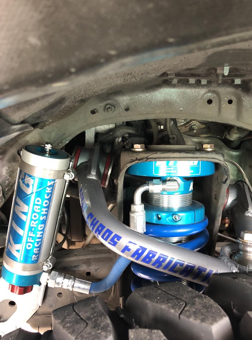

Inv4drZm did a full coverage set in aluminum last year, he wheels hard.
Seems like he didnt attach it to the frame, so no problems with body/frame flex.
Pg.54 post#804...and that would be in his build thread.
He sells some stuff, dont know about the liners though.
