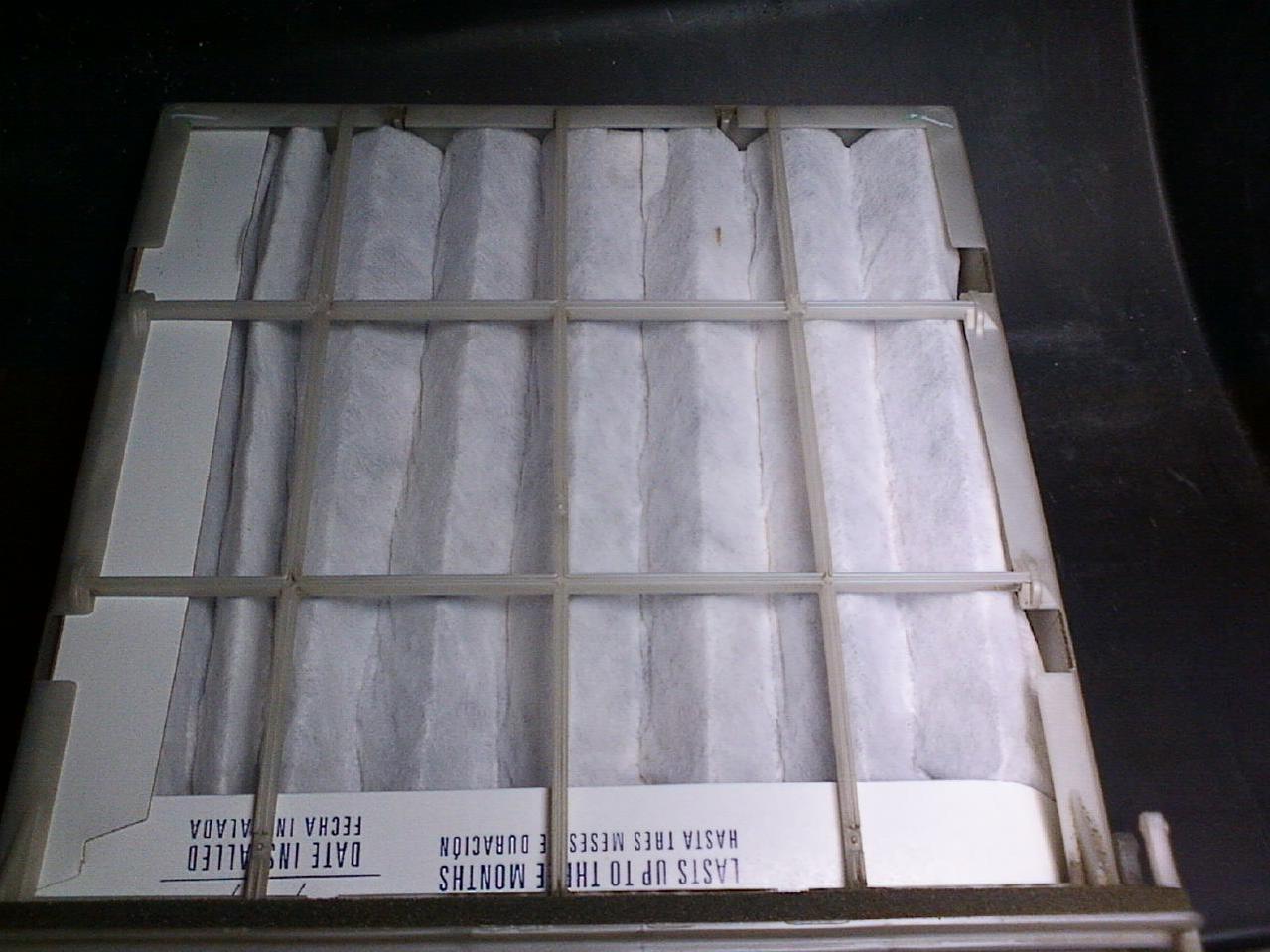

I bought a clean 2005 SR5 last week with 58k on the clock from a small dealer. One owner and great maintenance history. The only drawback is that it was smoked in, which I'm dealing with and will eventually eliminate the smell.
Anyway, I thought one of the first things on my list would be to change the cabin filter. By the looks of it I don't think it's ever been done. Not the best pic from my cellphone but you get the idea.

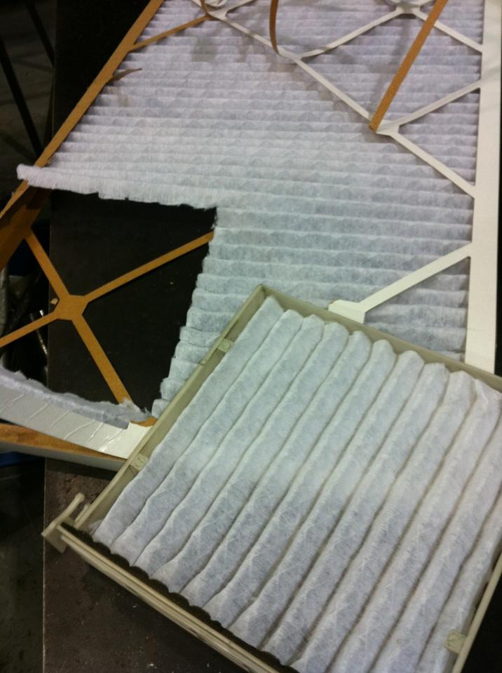

yeah thats all it is anyway. i do HVAC for a living and some of the filters you can find at the hardware store are 10 times better than that stock filter anyway. its so thin you can see through it! if you do go with a better filter you would have to change it more often, but it is also stopping more dust so thats the tradeoff
As for Cabin filters I Go to the Hardware store and by the best air filter for home use a/c and Cut it into Cabin filter size squares and for less than 20.00 I have a 5 years supply !!! I Off road ALOT And its Dusty Here in Arizona .SO I change it alot But check it out you be suprised !! Save Big $
I do the same thing. costs me about 2 bucks for a filter at walmart, cut to size and presto....done.

I found mine then pulled it and brought it into work with me. I found a 1 inch pleated filter we use for A/C units at work and cut out a square to fit my cabin filter. Took all of 5 minutes with a good set of scissors.
Best part....FREE
