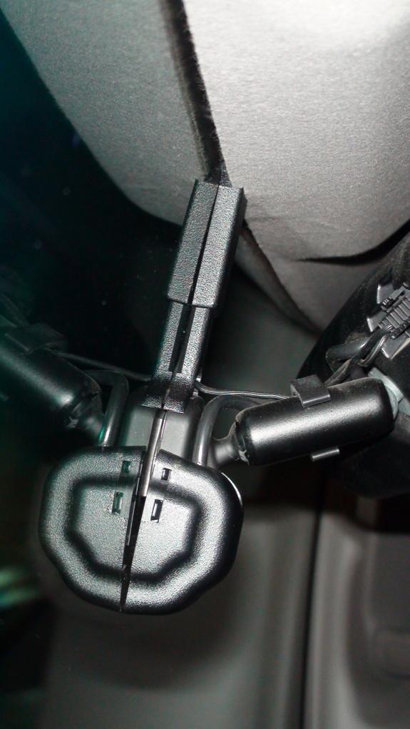

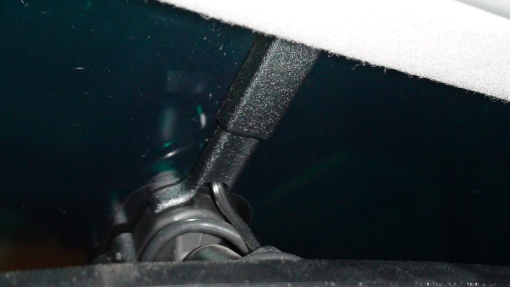

One question -- what did you use to cover the wire(s) going from the mirror up to the ceiling console so it looks tidy? Was there a piece that came with the rear view mirror that covers the wire where it has to travel that few inches across the windshield to the ceiling console?
Webby, I am sure you are correct. I just checked all the wires in the bundle behind the sunglassholder with a voltmeter and used the "ignition controlled" one. The mirror has a small plastic trim to hide the wires
