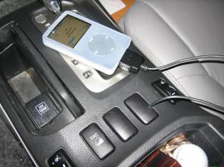

**I just ran outside and tooks some pics, as I know any and all threads are worthless without pics**
Here are some pics of the finished setup. One is showing the AUDIO screen, displaying the "CD CHANGER". Another pic shows the cord coming out of the open spot, and anothe pic shows where I want to do the custom install. Hit me up with any and all questions.
Ben

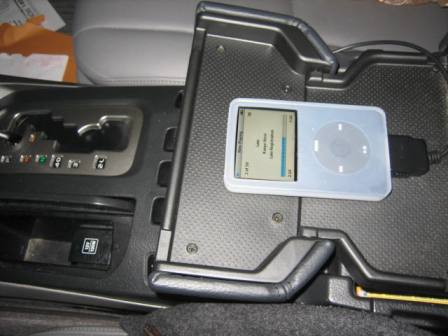

And finally the spot where I will peform the dreaded custom installation without local anesthetic.

When you hit the audio button, the display shows the artists/song playing, and when you hit the titles off button, it displays icons for discs 1 through 6. Having the unit on disc 1 lets you go from song to song when you hit the forward or back arrows on either the head unit or steering wheel. Disc 2 allows you to go from playlist to playlist by using the forward/back arrows, Disc 3 is for albums, etc.
Let me know if you have further questions.
Ben
