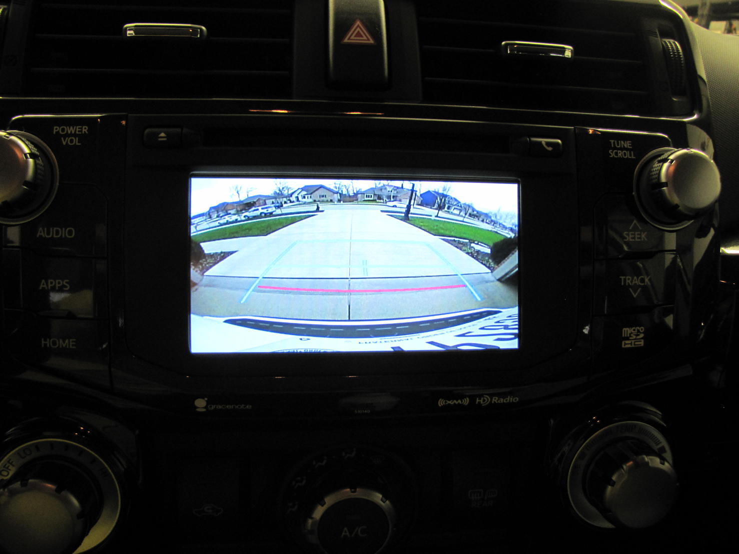

The second is the anytime rear camera module-

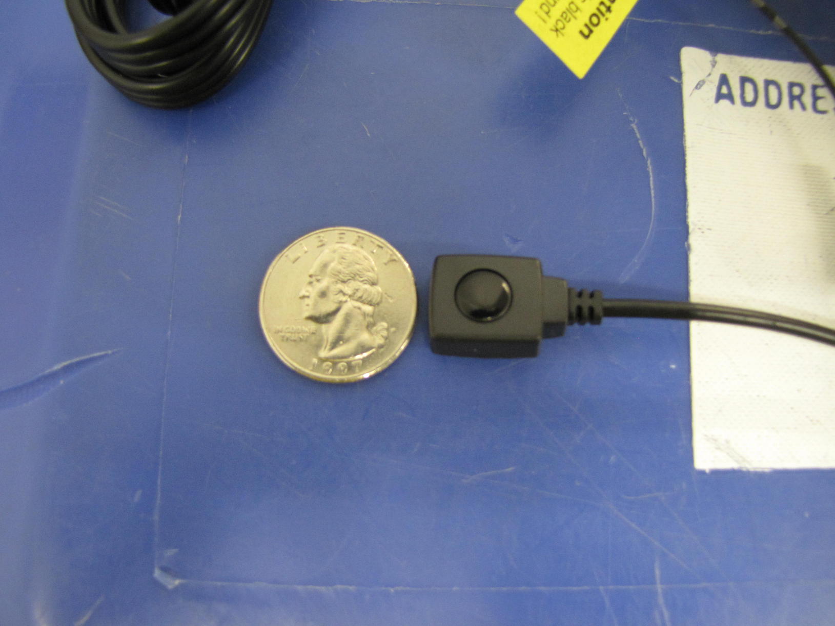

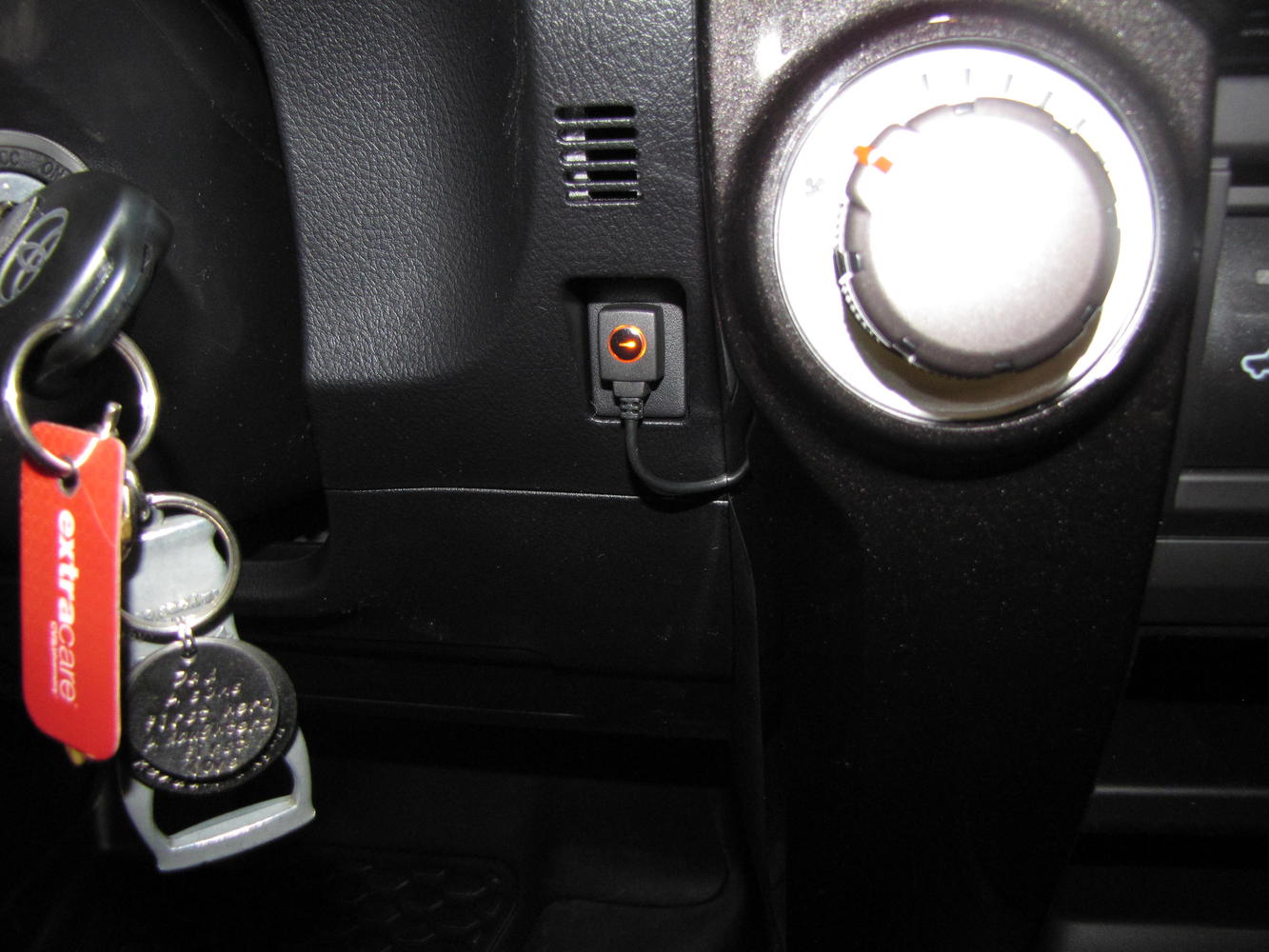

I know there are currently mods to do this for the Entune, but I did not want to cut,splice,tap anything. I wanted a true plug/play, so I went with the additional module. The two "daisy chain together" and plug into the ear of the Entune. This module does need to be activated via a small button. Once activated, the button glows orange and your factory backup camera is activated. It'll come in handy for me as I tow once in awhile and will hauling bikes on a bike rack once the weather warms back up.

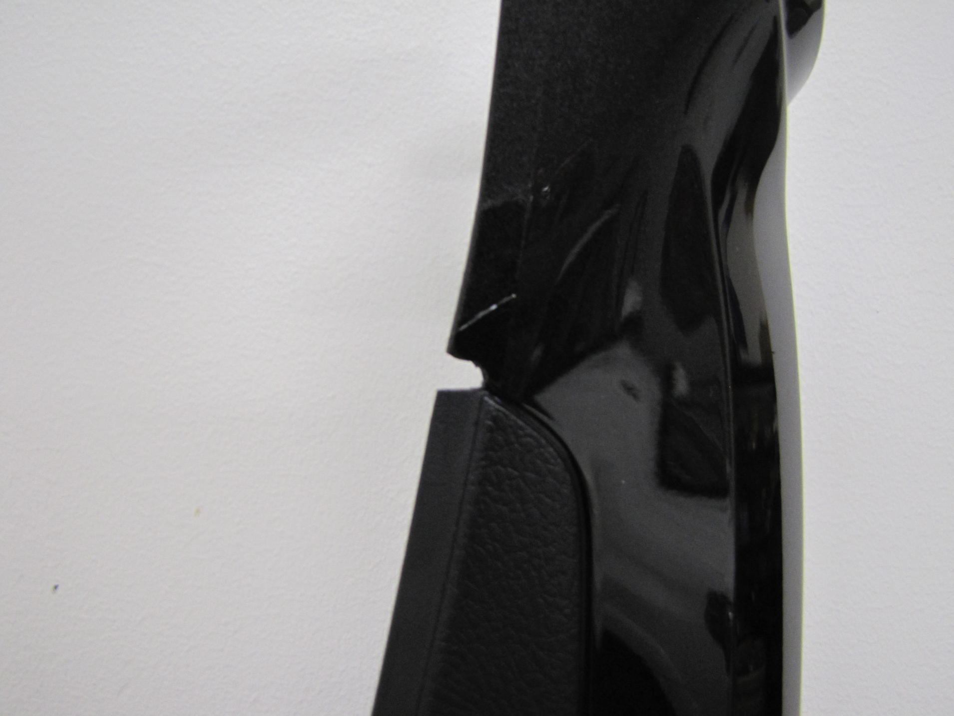

After using this on city streets and the highway last week and this week, I'm very pleased with the system. I found a nice blank spot next to the driver's side trim (slight modification needed with a dremel) to make a notch for the wire in the side trim.
