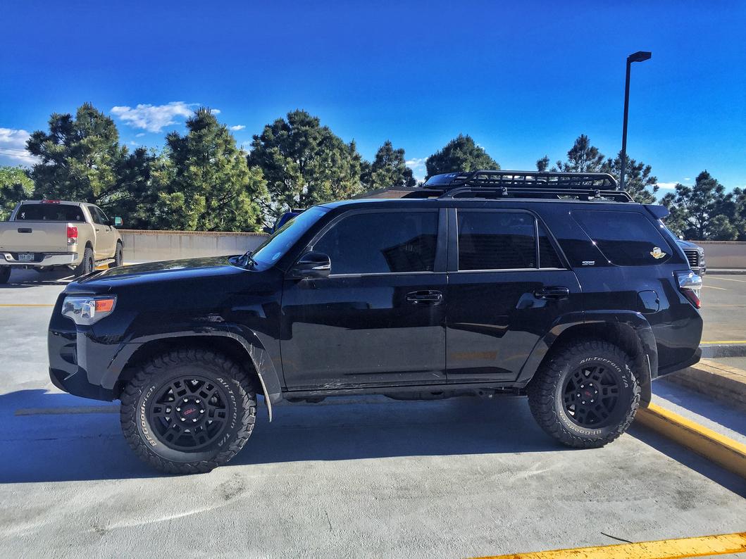

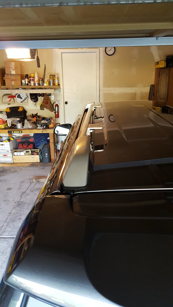

Installed: Rola low-profile mounts on 5th Gen
Guess it's not that old but ya would love to see it.
Been trying to figure out what I want to do with mine. Either a system like this, an N-FAB basket, or just wait until I can get a baja/gobi
The only thing that would compel me to spend $1k+ on a rack would be going to aluminum. I'm pretty happy with the Rola rack, though I am having to get creative with mounting stuff to it. Should hold me for a few years, or, at least as long as it takes to rust.

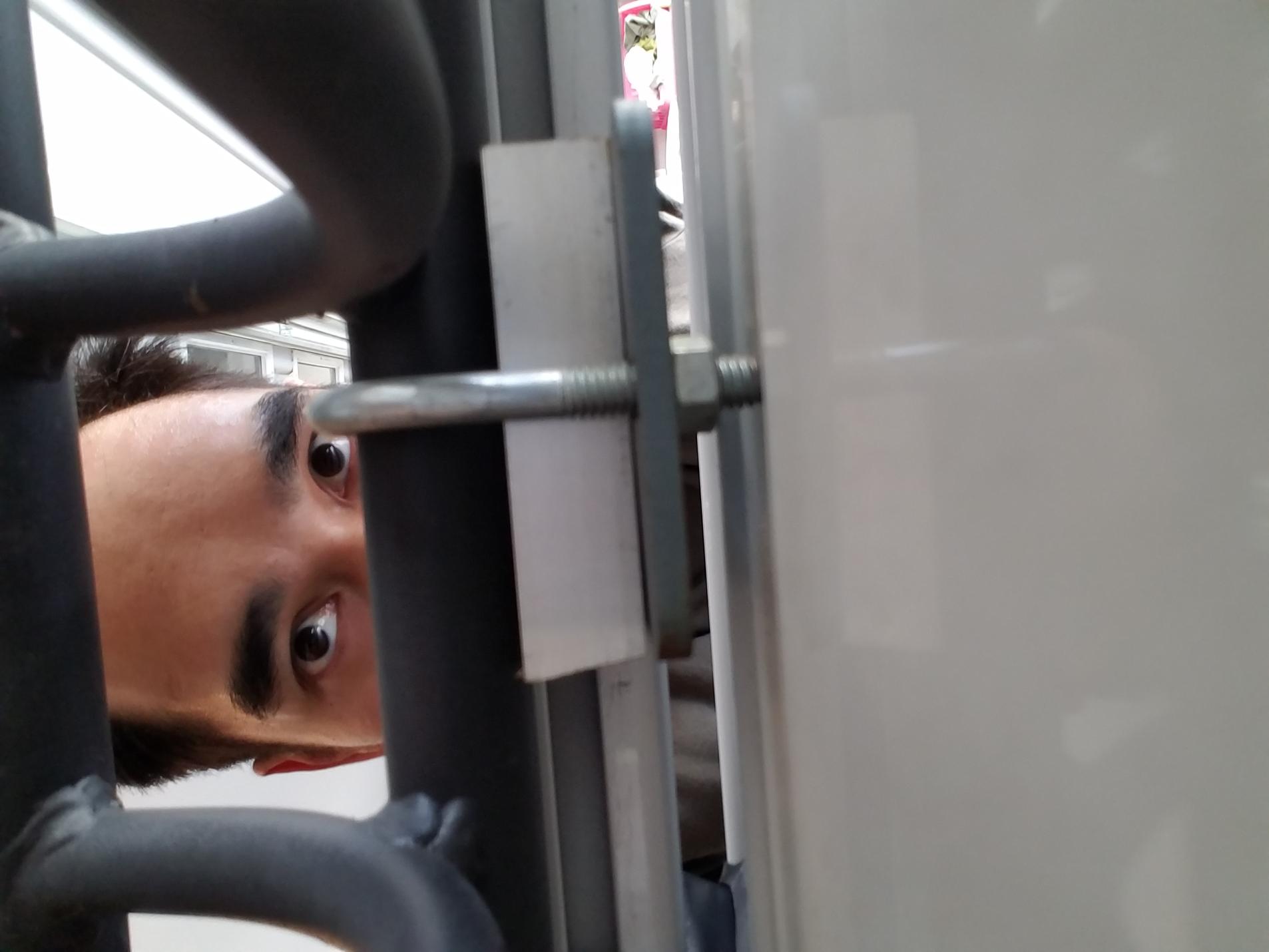

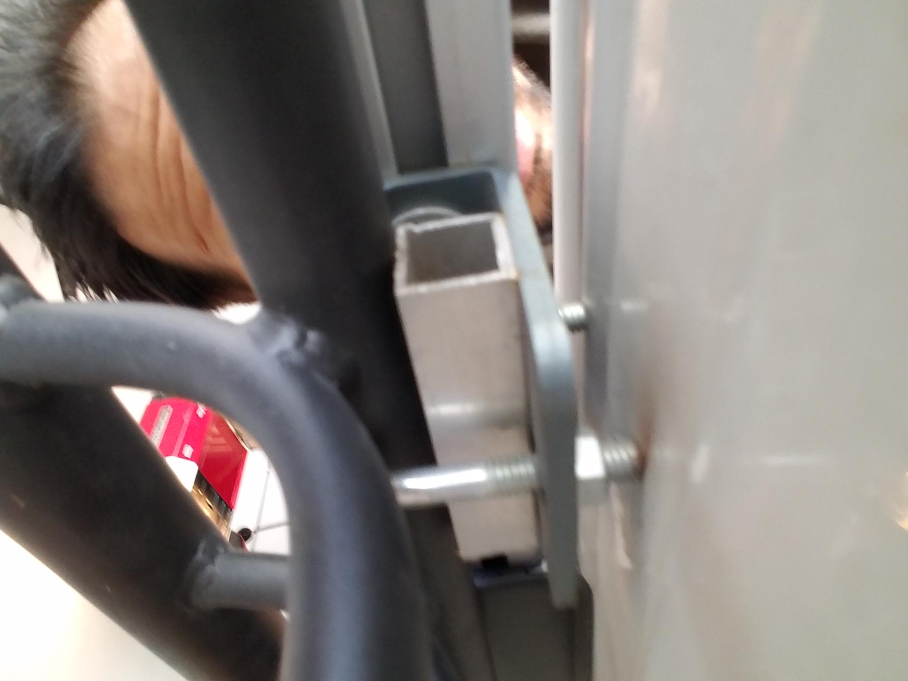

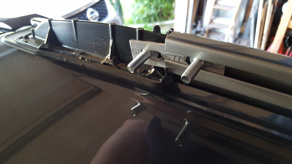

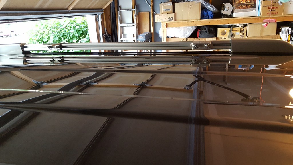

Here is tbe "spacer" that i did to be able to have clearance from the rack seating on the roof.
1" square aluminum tube
Longer U bolts.
Sorry for the pic quality.
After spending an hour on sealing the holes, I can see how it would be easy to miss several, resulting in the myriad rusting issues. Also, the fairing mount holes are not so easy to seal, so we'll see...

- Ecko - thanks for the spacer pics (staring eyes kinda spooked me!), but I think the height of the rack is basically the same as if you had just inverted the mounts in the first place?

- Ecko - thanks for the spacer pics (staring eyes kinda spooked me!), but I think the height of the rack is basically the same as if yuo had just inverted the mounts in the first place?
Seems about right, though those bolts look way closer to the roof than mine are. Can't imagine having to get those nuts on/off more than once without flinging a wrench through a window in exasperation.
mcarey - I think the Rola is about half the price as Yakima baskets
b407, ecko - now that I look back at ecko pic from earlier in the thread, the basket does seem to sit a bit lower with his spacer setup, but pretty tight clearance bolt ends to roof...okay for a full time install but not something I'd want to take on/off often.

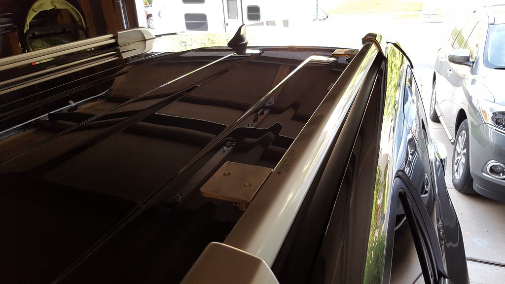

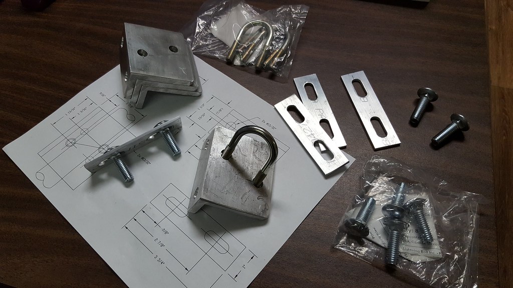

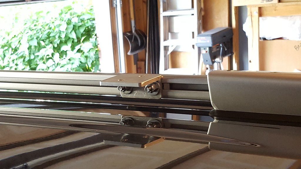

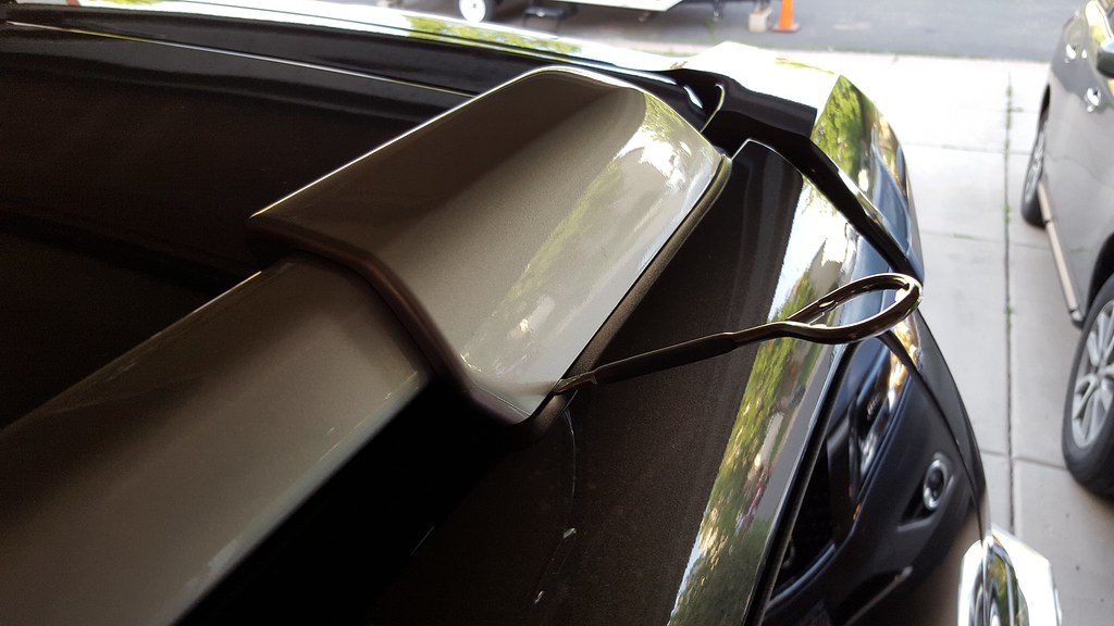

[MENTION=144051]b407driver[/MENTION], thanks for the inspiration… you saved me about $100 having to buy a set of cross bars to mount my Coleman roof basket!! Fabbed a quick set of brackets out of some 1/4" alum angle. Lest anyone copy the dimensions, keep in mind these are NOT FOR A ROLA RACK!! My Coleman basket measures 39” wide, which I imagine is close though.

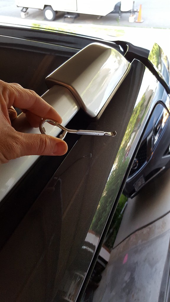

In looking at factory cross bars on Amazon some months ago, I read one reviewer who suggested using a paint lid opener to pop off the end caps. BRILLIANT!!
Punched some 3/8” wide slots in a piece of 1/8” x 1” aluminum flat bar to use with some carriage bolts in the factory rails.
Installed.
Nice work! Cool to see someone fab a set of these to their exact needs. The basic concept of the angle bracket seems like it could be adapted to a lot of uses, and I wish companies like Rhino would make an option like this instead of relying on the stupid crossbars; so much more elegant a solution.
