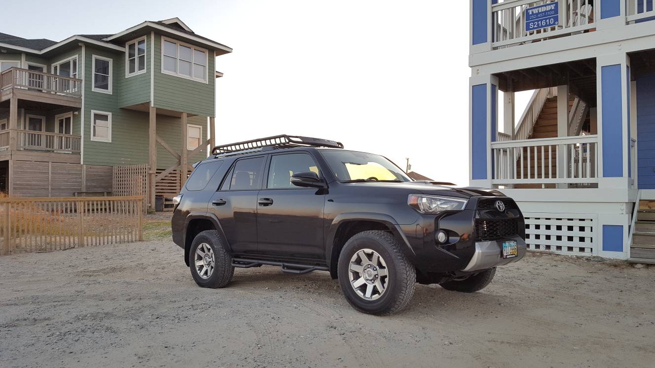

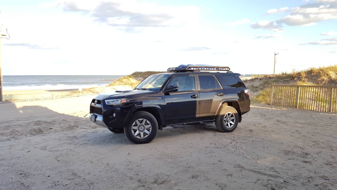

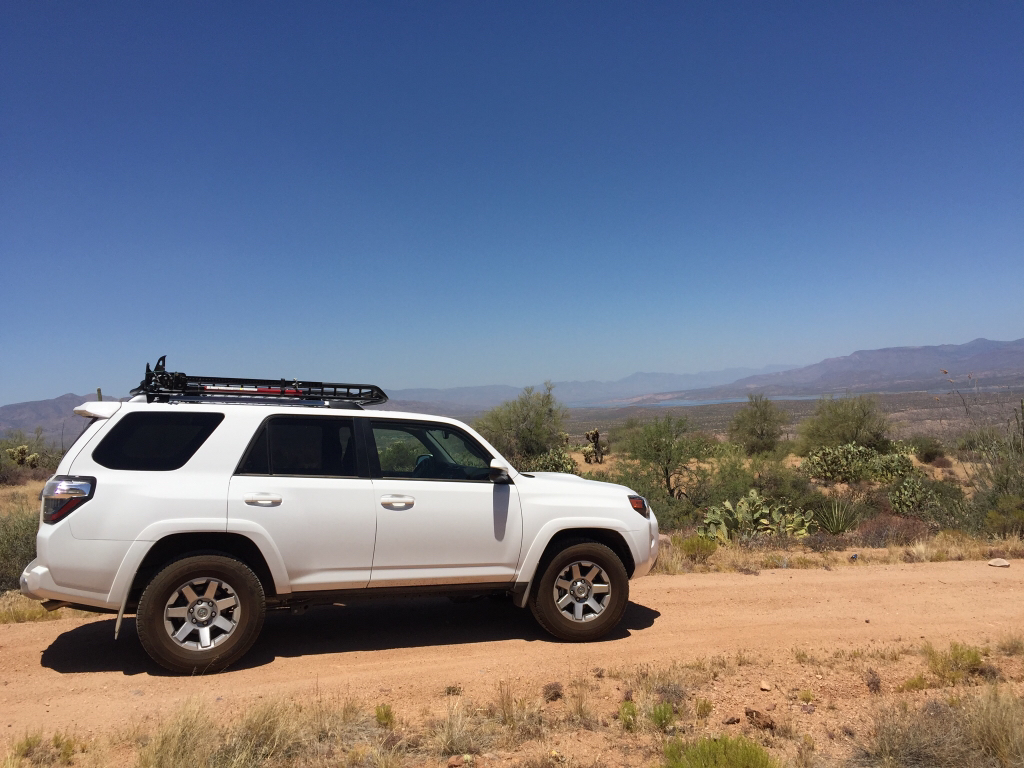

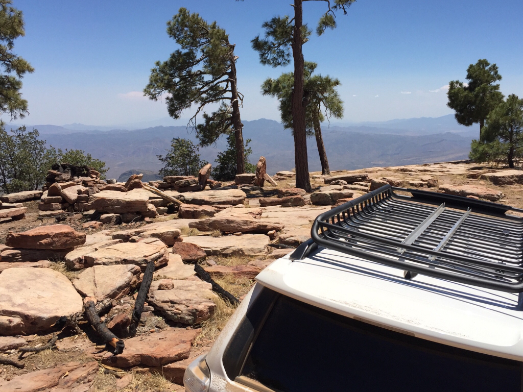

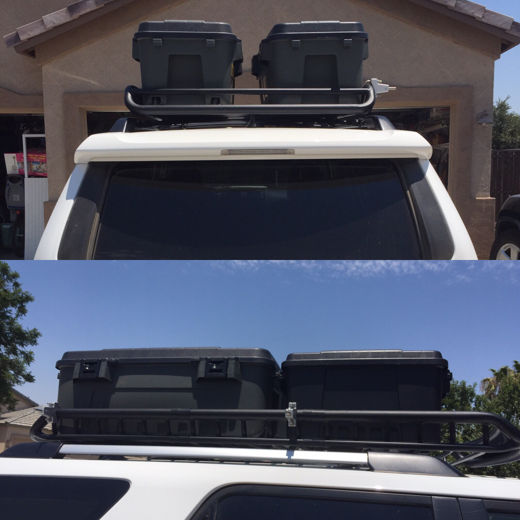

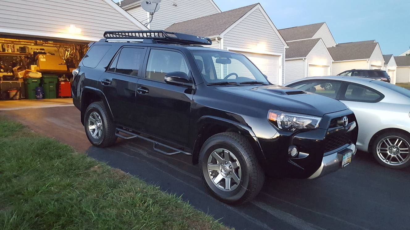

Here's a few.
Here are a few pics with the extension, I mounted about as low as you could on the factory rails. It is loud at highway speeds with nothing in it, sounds like a plane flying directly overhead. Quieter with a couple of dog cages wrapped in a tarp on our trip to the outer banks. I keep it off the truck unless I need it.

Thanks bro that looks great. Do you think it's so loud due to it being closer to the front of the roof? Have you run the rack without the extension before? If so, do you notice the difference? Ive had mine with and without cargo up there on the standard size and it isn't much louder than when I don't have the rack up there.
never ran it without the extension so I couldn't tell you.

Thanks! Do you notice lots of wind noise with the rack and extension? Ever had it without the extension? I can hardly tell the difference bt having the rack or not without the extension.
Yeah, I can hear it. It got louder with the extension, I had some vibration that I really couldn't explain. I'm thinking something is loose somewhere but haven't tracked it down. At highway speed it would make humming sound that I can only think of as some harmonic vibration. I put a ratchet strap on it and it went away but that's not a permanent solution. So until I figure it out I added this aluminum angle that also stops the noise and is spaced so they hold my cases to the outside of the rack.
I think the noise comes from the amount of overhang in the front. With the factory rails spread out as far as they will go the mount is still on the first rails of the front section of the rack.
Without an extension, mine had the harmonic vibration (that's precisely what it is) between 60 and 75 mph; you could put your hand on the headliner and feel it, and the sound would increase/decrease with speed, but not linearly (i.e. once you slow quickly, the vibration slowly quiets to nothing). Drove me nuts for the first week, during which I finally tried mounting a load, and the vibration immediately went away.
Now that I have two Rotopax plates permanently installed, the vibration no longer occurs. Prior to that, I had used a bungee cord threaded in and out of the center of the bottom tubes across the center to break up the harmonic, worked great.

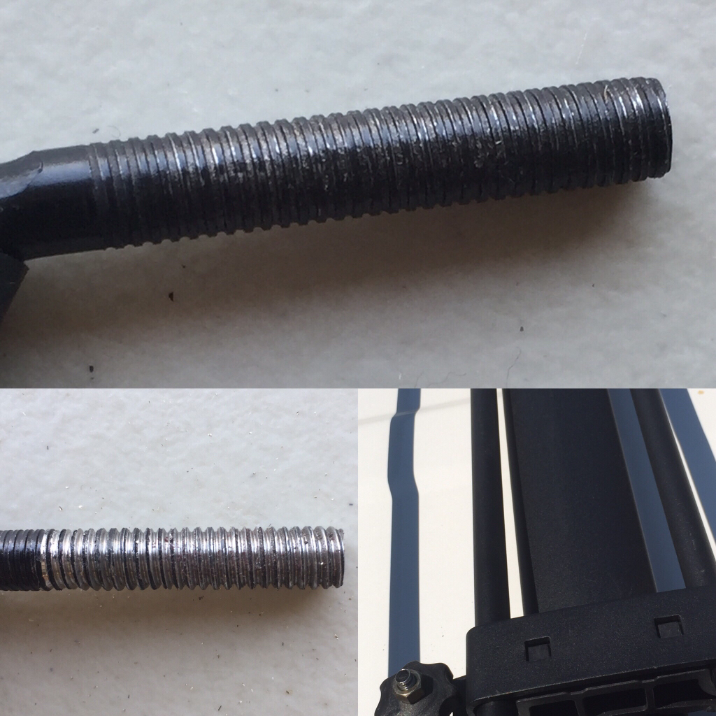

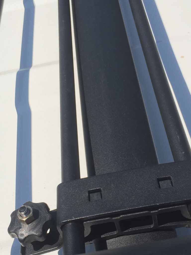

I'm not impressed with the knobs for tightening the rack. One of my mounts was bad from the start. I had to re-thread both ends and then backed up the knobs with nuts since the threads were too far gone on the knobs.
I emailed Rola but got no reply. I bought the rack privately so I can't go back to a retailer. But since it had never been installed I tried to get something from Rola. But apparently customer service isn't on the priority. I really didn't expect anything from them but a reply would be nice.
