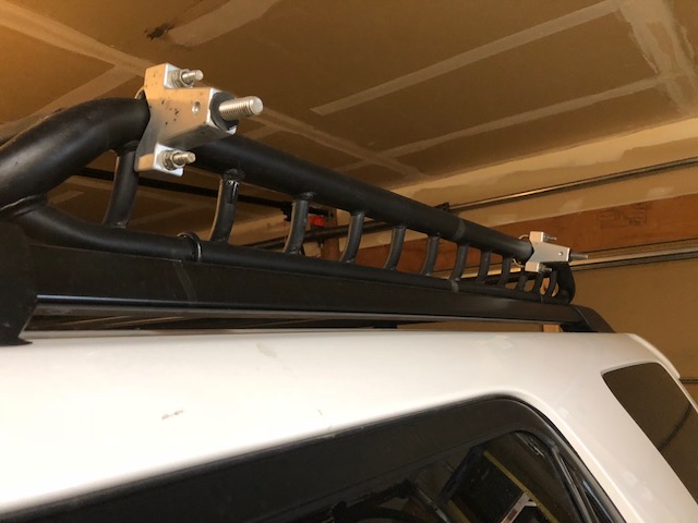

Installed: Rola low-profile mounts on 5th Gen
No, and no; they are solid. I temporarily avoided the rust issue (at least on top) by putting a layer of rubber (Vycor) on the top of the plate, but in the first round it stretched a bit and left a gap on either side of the tube. There was only a very slight amount of rusty residue in the 'open' area. I may remove this winter and have the brackets powder-coated.

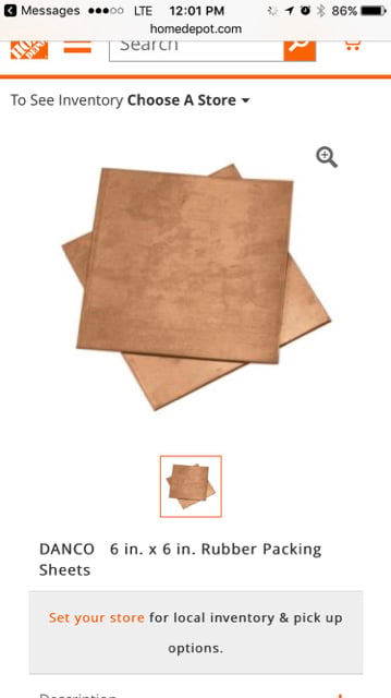

Gotcha. Good to hear about the bolts not coming loose even without loctite! I also used these rubber packing sheets on top of the brackets. Seems to be working out well so far. No signs of rust after some heavy rain.

Is it only the L bracket/mount that comes bare and needs to be finished? What about the bolt/nut that secured the mount to the rails? I think I read the U bolt is stainless?
Yes, they appear to be some form of stainless, but I'm not sure they are completely rust-resistant. When I removed the rack after being mounted for 2 months, there was a thin line of rust along the contact point with the tube, though when wiped down, you couldn't see anything on the u-bolt. I assume it's some form of galvanic corrosion due to contact with the powder coat of the tube. I since primed/painted the u-bolts satin black, though not sure how it will hold up. Wish I could powder coat the L-bracket and u-bolt, but at this point I just want to use the thing.

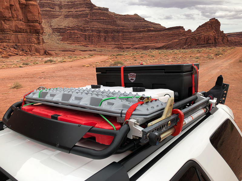

For my second White Rim run I was carrying 8-gal fuel in Rotopax, 4-gal water in Rotopax, a Hi-Lift, WaterPort (3.5-gal), MaxTrax, and a Rola bag on top of it all (believe it or not) with probably 75-lbs of gear.
Rock freaking solid. And I drove the whole trip like I stole it, trying to see how fast I could get through the lap, even if we did spend 3 nights out there. Fun $hite.
EDIT: One quick note about getting the Hi-Lift branded mounts attached to the Rola rack. The spacing of the 'crossbars' that the mounts need to be attached to dictates that there was a grand total of TWO options that would work for me. One had the foot of the jack too far forward (which I didn't want), so it took about an hour to find a combination to fit the hole spacing of the Hi-Lift on the other side of the vehicle. The main problem is that the 'loose' manufacturing tolerances of the Rola dictate that even very small variances in bar spacing/angles resulted in not lining up with a set of holes that theoretically should line up based upon the average repeated bar spacing. If you try to do this, your mileage will vary, so what works for one rack may not work for another, and it may take awhile to find mounting bracket locations that work (for example, mine has one less bar in between brackets than BigDaddyK's does). It is, however, rock solid, no complaints with the setup now that I've found the magic combo.

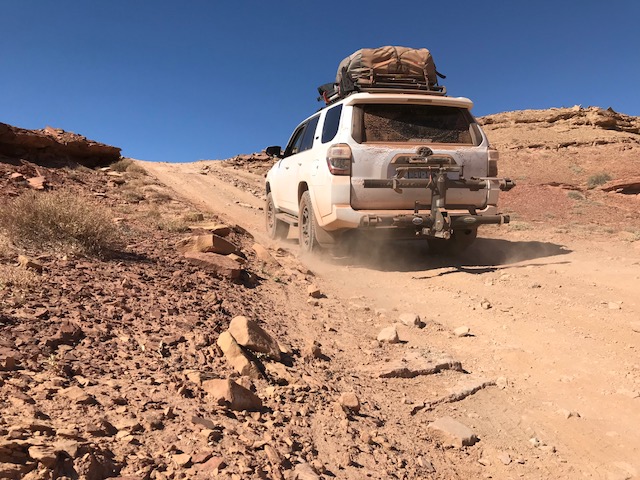

Just got back from my third White Rim trip in the last 10 months, and loaded the Rola up a bit differently than last time. Instead of the big ol' Rola bag, I used a light-ish plastic box I found on Amazon that fits perfectly in the back of the rack. Hauled light stuff, just need to figure out a better way to mount it so that I don't have to remove the straps to access it.
Still rock-solid. It was Jeep Safari Week in Moab, and I ran into three rigs sporting identical BILSTEIN paint jobs. Bunch of nice guys, got to pick their brains and they were thoroughly checking out the Rola with all that gear on it. They yanked hard, and were surprised it didn't budge.
Probably the best $130+$80 I ever spent on my truck.
