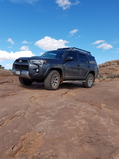

Here's mine, Love the rack...had to take it down recently to paint the rails black (not pictured)
Thanks to this forum, I found the 4X Innovations Rola mounts and used them to get my new Rola rack on two days before I left for Moab. The mounts held the rack and about 100 lbs of gear for 6 days.
Does anybody have a good, secure way to mount Plano cases? I used two of the sportsman's trunks to keep gear in, but I just fastened them down with bungee cords and ratchet straps.
