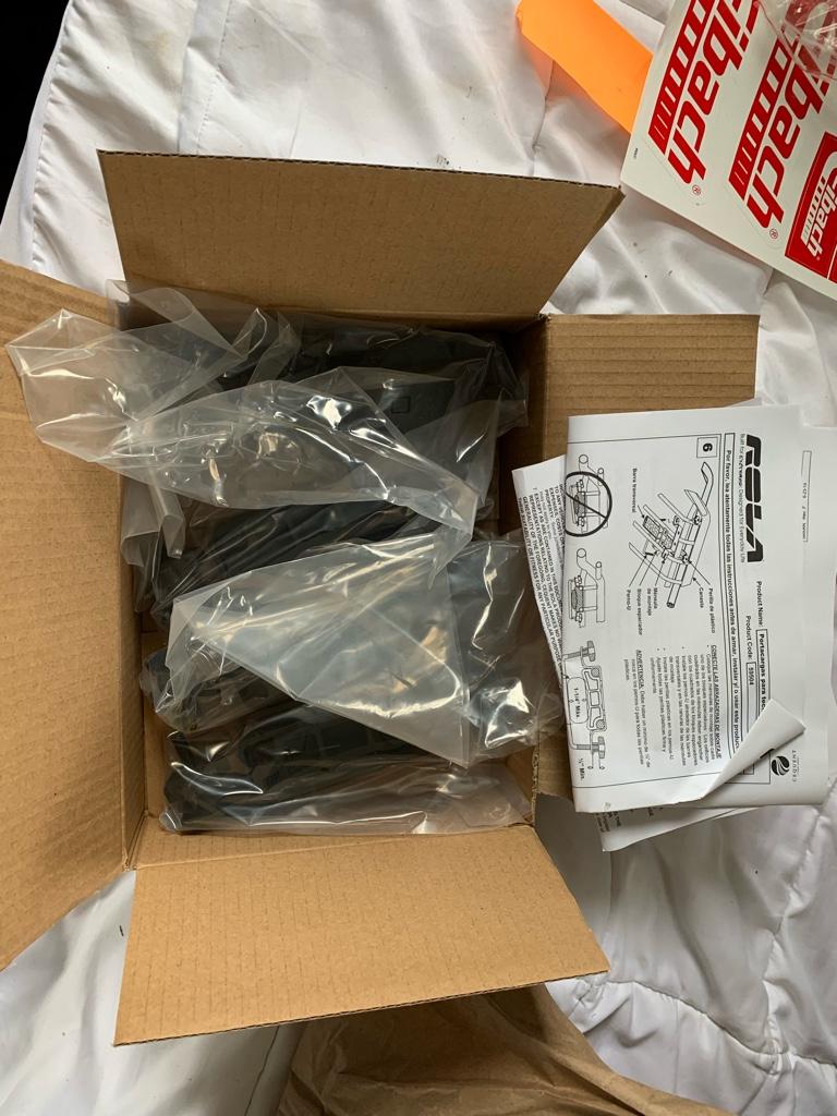

Does anyone who has done this have the mounts that come with this rack and want to get rid of?
I ended up doing the low profile mounts, and thought I saved the Rola mounts somewhere. After moving into new house I can't find them. I upgraded to Prinsu and am trying to give the Rola to my buddy with a Subaru Crosstrek.
Ya man, I got mine still in the box. Located in KC.

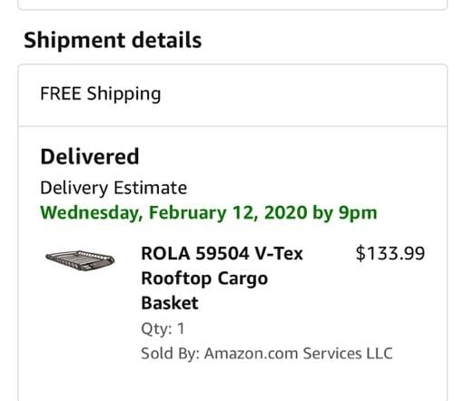

I bought mine like two months ago on amazon for $134. I bet the COVID crisis jacked up the price.
$210.58 today on Amazon
Walmart.com is now the least expensive
Yup, I looked it up on google and everyone has it way up. I'll wait and see if it drops back down as I don't really need it yet. Have a cruise booked May 30th and I'm expecting it to cancel, our May 13th one already has been.
