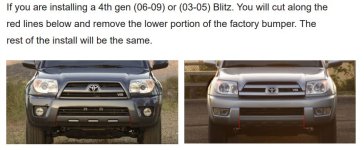

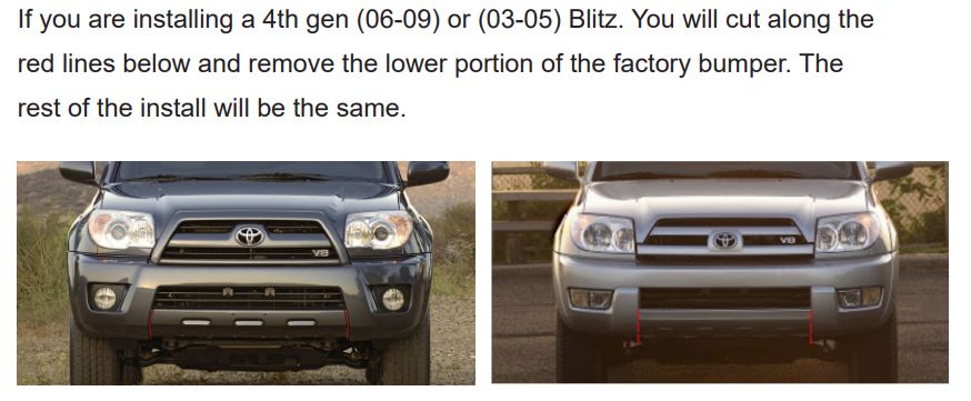

I had to cut all of the bottom valance and the bottom 'grill'. I tried to remove the grill without cutting it, but that wasn't going to happen.
I was just looking at the instructions for installing this. Did you have to remove the bottom grill? Asking because this picture shows cuts to the bumper, but not the grill on the 4th gens....
I imagine by “bottom grill,” he meant the part that’s in the bumper, not the one that’s part of the hood. It has to go per this image from V4x4’s site.
So you can do either. You'll have to remove the bumper for the install. You can either just cut all the way through the lower "grill" or just make the cut on the bumper and then it just pops out
you don't have to remove the bumper, I didn't. But you do have to cut the lower valance and the black 'grill' part out.
