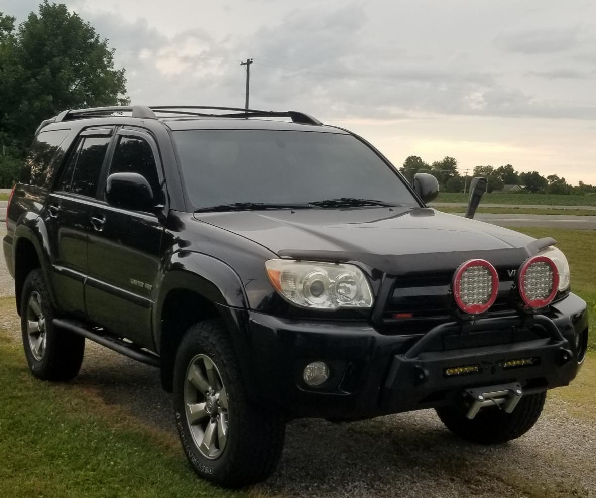

I received and installed my Victory 4x4 bumper with some additional fun things today! Smittybuilt 97945 winch and some ARB Intensity knockoffs and 20" slim light bar with yellow lamin-x. Love how it turned out!
Nice! link to those arb knockoffs?
Amazon.com: LED Light Bar, Northpole Light 2x 9Inch Round Off-road lights 96W Cree Spot LED Work Light Driving Fog Light with Mounting Bracket for Off-road, Truck, Car, ATV, SUV, Jeep (Red): Automotive
I used KC tube mounting brackets to mount them to the bumper. Here is the link to those as well if you're interested:
Amazon.com: KC HiLiTES 73071 Light Mount Tube Clamp for 1.75" to 2" Bar (pr): Automotive
