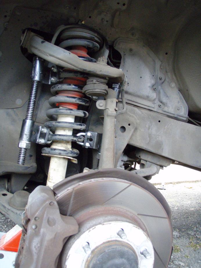

Step 1...install spring compressors with the vehicle still on the ground.

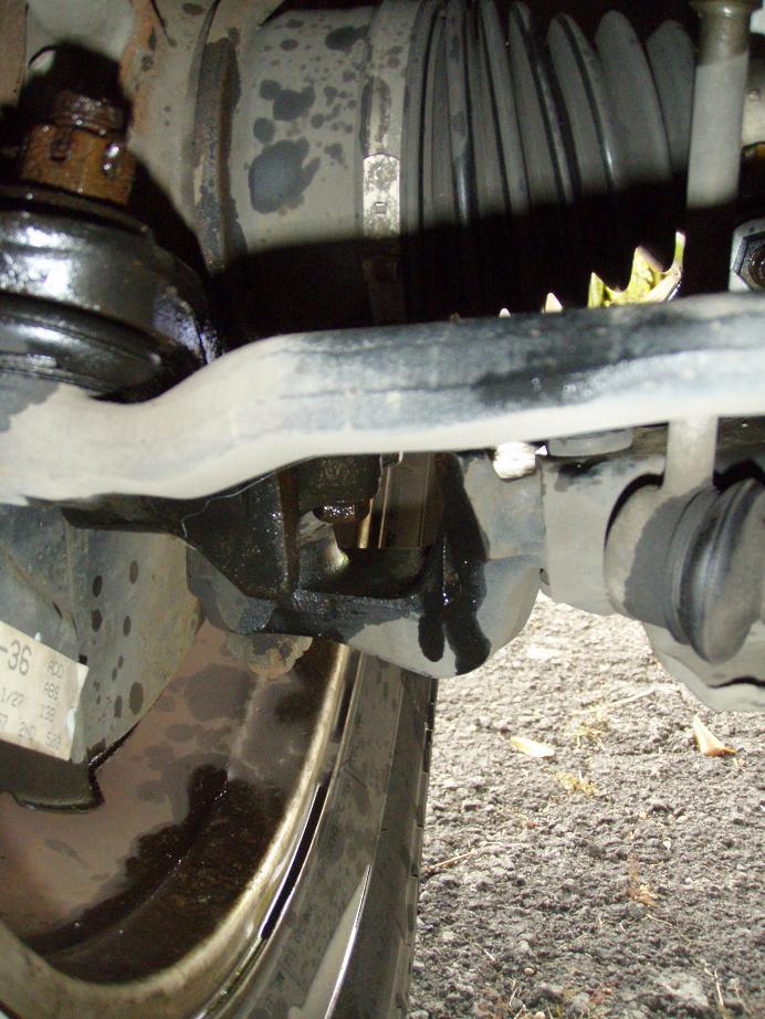

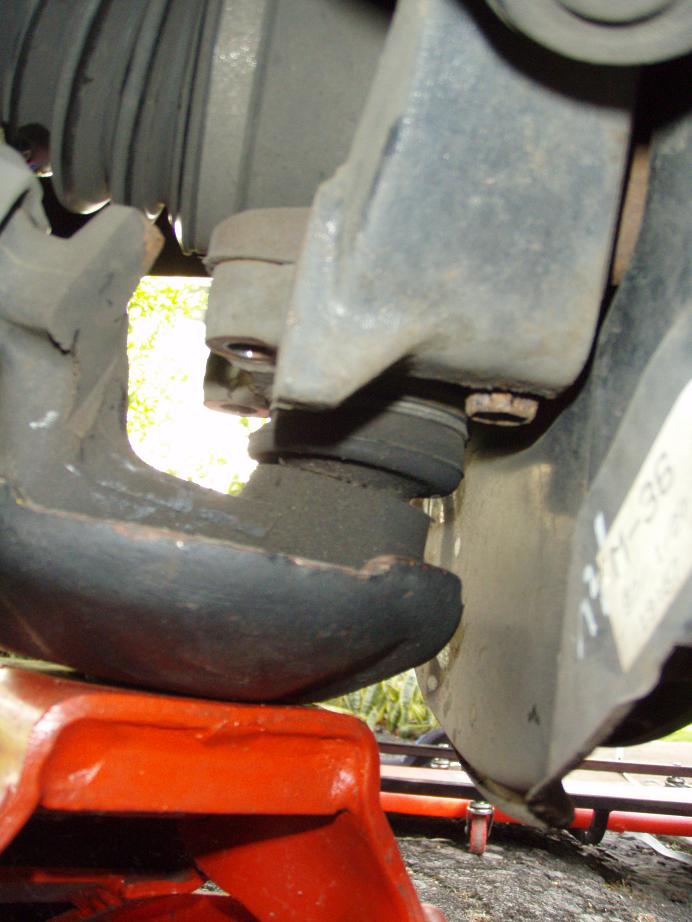

Next loosen the 4 bolts that attach the spindle to the LCA ball joint

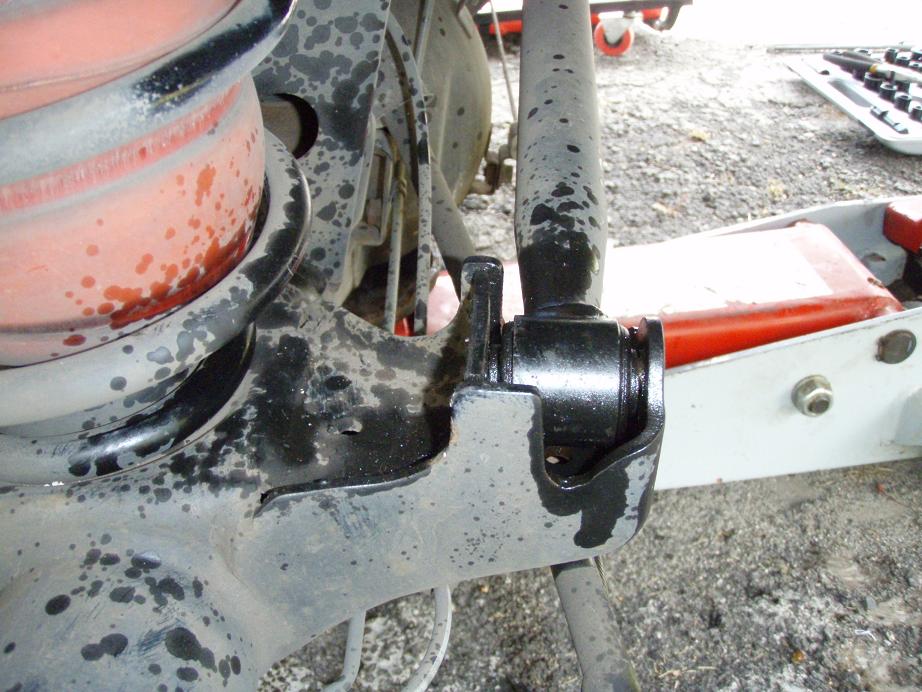

Next, raise the vehicle. Support with jackstands, then place a floor jack under the LCA.

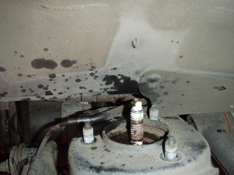

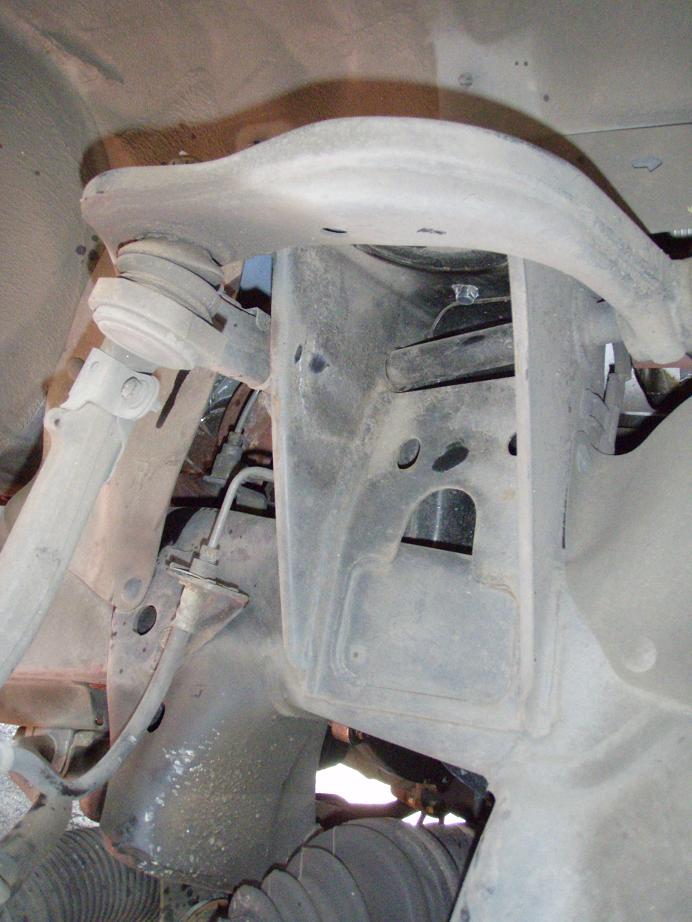

Remove the 3 nuts that attach the strut to the strut mount (I also removed the upper strut nut, but DO NOT do this if you don't have the spring compressors in place.)
Remove the 4 bolts connecting the spindle to the LCA ball joint. (This will allow the LCA to fully lower out of the way...be sure to support the front cv shaft with wire or something).

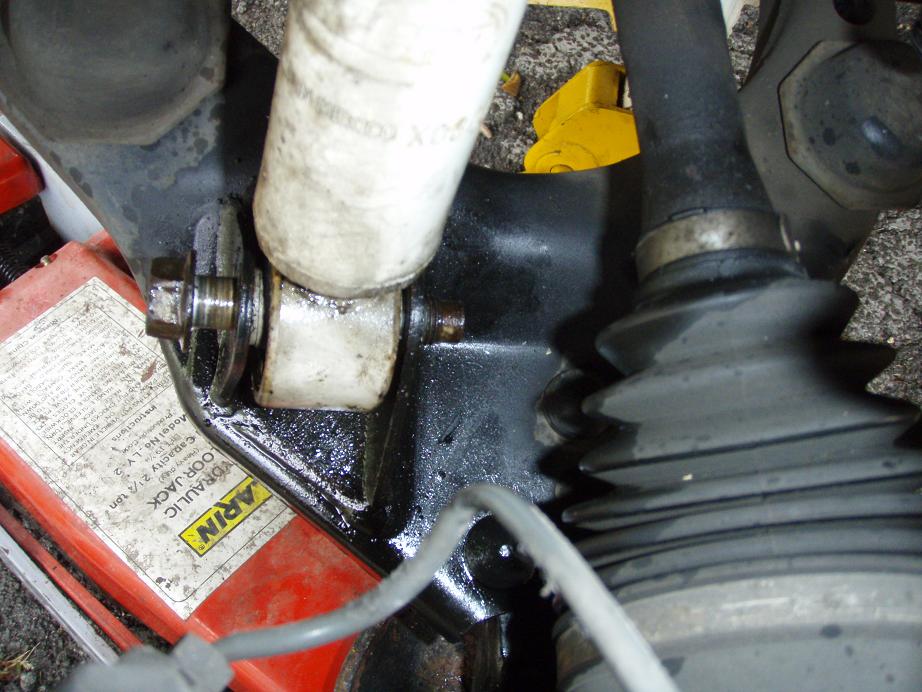

lower the LCA (supported by the floor jack) and loosen, then remove the lower strut bolt.

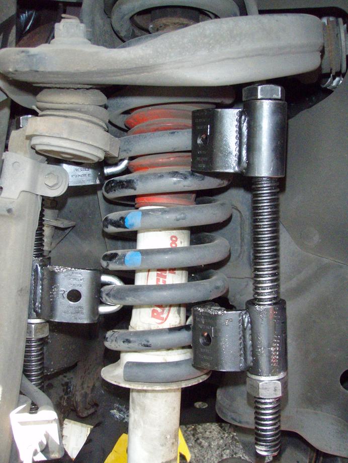

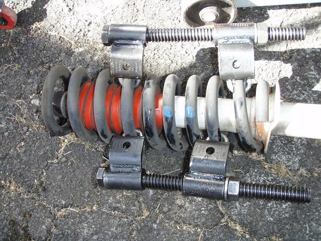

remove the upper spring perch from the strut, compress the springs about another 1.5" to allow clearance for the new spacer.

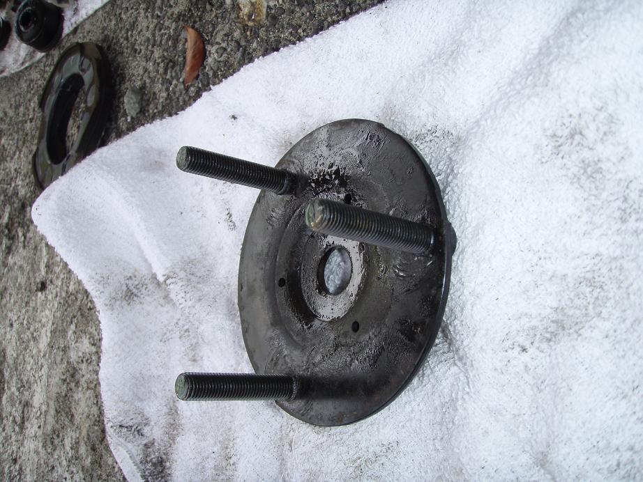

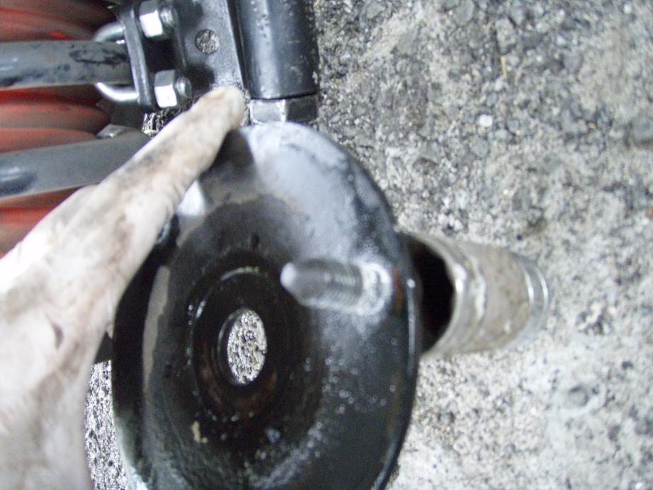

Remove the old upper strut mount studs by placing the stud over a deep socket and pouding them out with a BFH.
install the new longer upper strut mount studs by using the BFH and deep socket

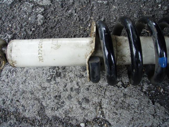

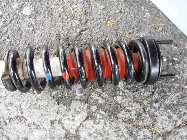

ensure the coil spring is seated properly in the strut (this is where some people run astray, and their lifts heights between driver & passenger are different).

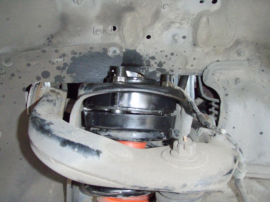

install the new strut spacer and upper strut mount nuts

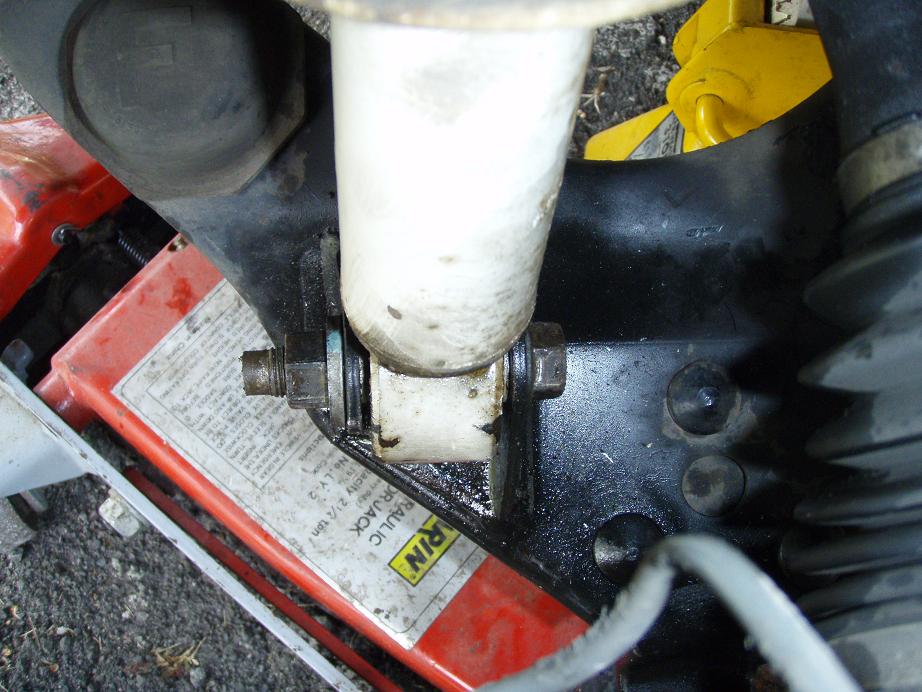

It takes some fiddling, (I used a long pry bar to force the LCA lower, then a steel bar through the lower strut mount to get the lower strut eye to align with the strut mount) it's easier if you have two people...unfortunately I was flying solo today.

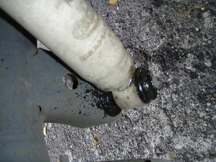

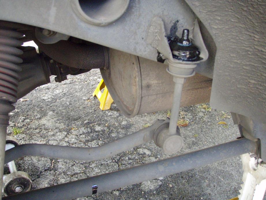

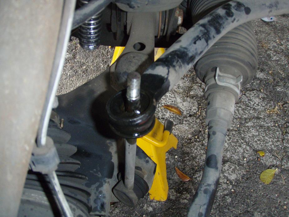

On the Rear...step 1 remove the sway bar nut
