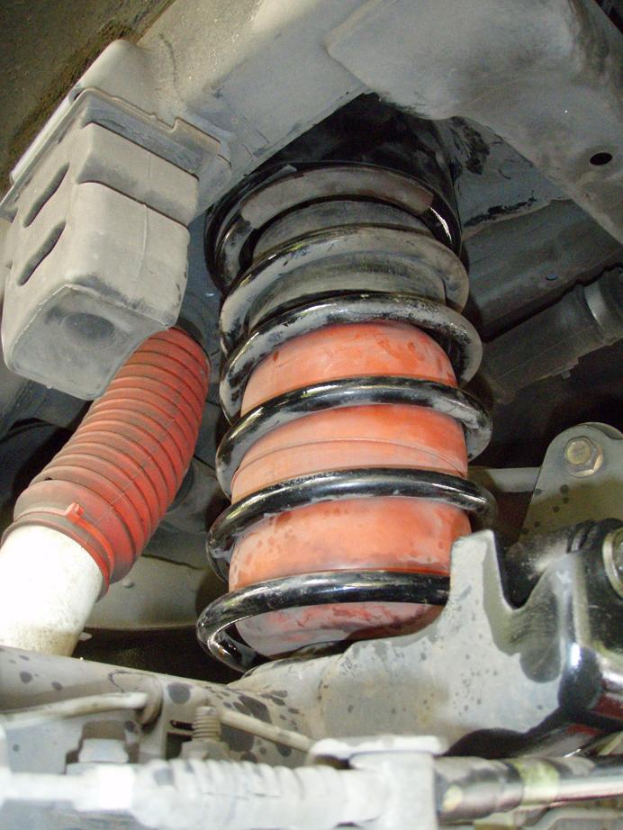

Remove the rear spring (in this case I have airlift 1000's), and reinstall with the new spacer...it's easier if you zip-tie the spacer onto the top the coil before reinstalling
repeat the same for the other side.

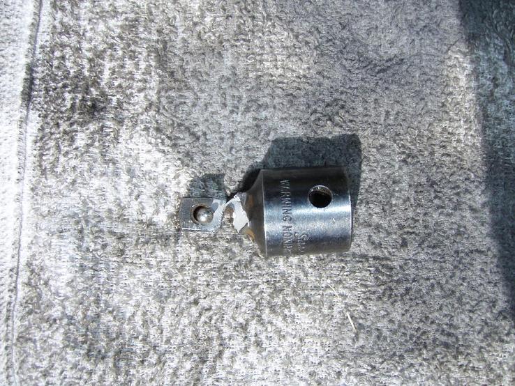

Here's the only casualty of the day...my trusty Snap-on 1/2 to 3/8 adapter finally gave up the ghost...
After all was done, I measured 2" of additional height at each fender.
The whole process took around 4 hours of labor (took many breaks...my dog was helping me).
Hope the pics were helpful...PM me if you need additional info...
