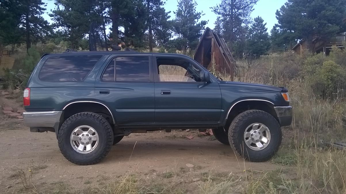

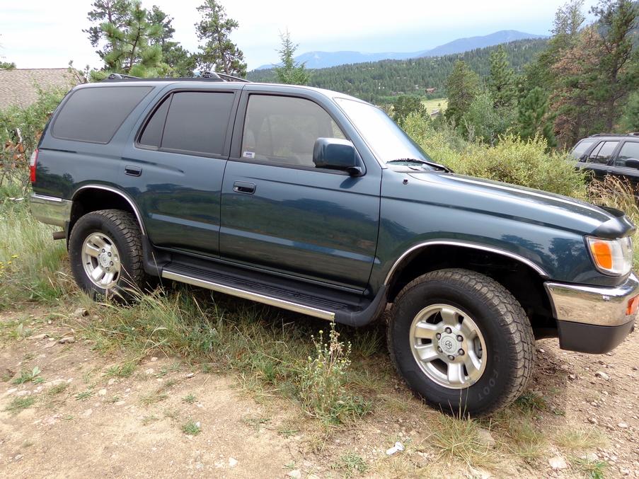

So OME heavy springs front and rear with OME shocks front and rear, Spidertrax hub centric 1.25" spacers, stock 16x7 wheels, and 285 75 r16 BFG All Terrain KO2 tires. BTW, I'm not sure how you guys fit that size tire on there. Discount Tire didn't want to install my wheel spacers so I ended up installing them in a parking lot nearby and coming back lol. I thought they could fit, then when I got home I could install the spacers before I went for any real offroad driving. Sitting flat on the ground with the full weight of the truck the tires hit the UCA's unless sitting almost perfectly straight, so I couldnt have even driven it home. Then, they only had two of my tires in stock even though I called them and paid them over the phone yesterday, so a guy had to drive to another store to get the other two.
Long story short, I can already tell some things are going to need to but cut, removed and persuaded before everything will be smooth, might even need a 1" body lift. I'll be doing some flex testing tomorrow. Anyways, thanks for the advice and here are a couple pics.

wow, I just bought a 99 4runner 3 weeks ago and it is identical to yours. I too want to install an ome lift. I only want to run 265 75's on it though. want to keep the tire weight down. it looks really good with the lift and looks like it sits really level. did you buy new shocks for it? how does it ride.
[MENTION=129926]Doctordel99[/MENTION] I am not an expert on this generation of 4Runner by any means (had 6 1st gens and 2 second gens though lol). I think if you put the heavy springs on and have 2" spacers on in the front you will get the rake you are looking for. I have it set up with the heavy front springs and OME shocks and still have a good rake as you can see. I would do the rear springs without the spacers first if you decide to try it.
[MENTION=124765]highcj5[/MENTION] I kept the used shocks in the front and bought medium shocks for the rear. It rides VERY nice. It also flexes really well (for IFS), too well in fact so I will need a body lift AND trimming for sure. It rubs the firewall hard (while wheeling some rough stuff, not street driving). It might be ok if I didn't remove the sway bars though.
