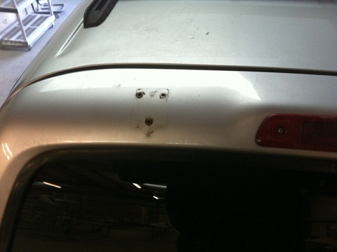

Yep, if you take yours off as a comparison you should see three holes under each of the 2 feet that hold it on (pictured below). You'll need to duplicate those holes to bolt it up (making sure the 3rd brake light is centered in the deflector opening. Don't forget plenty of silicone to make sure no water can leak under the feet and into the mount holes.

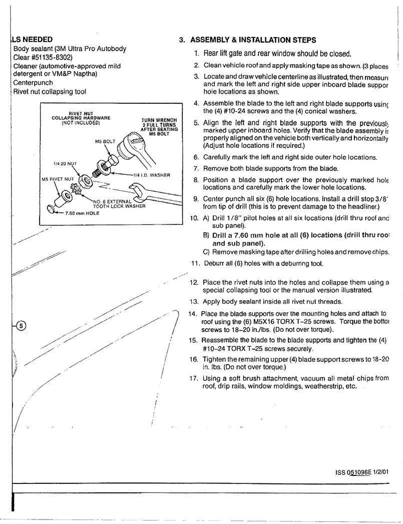

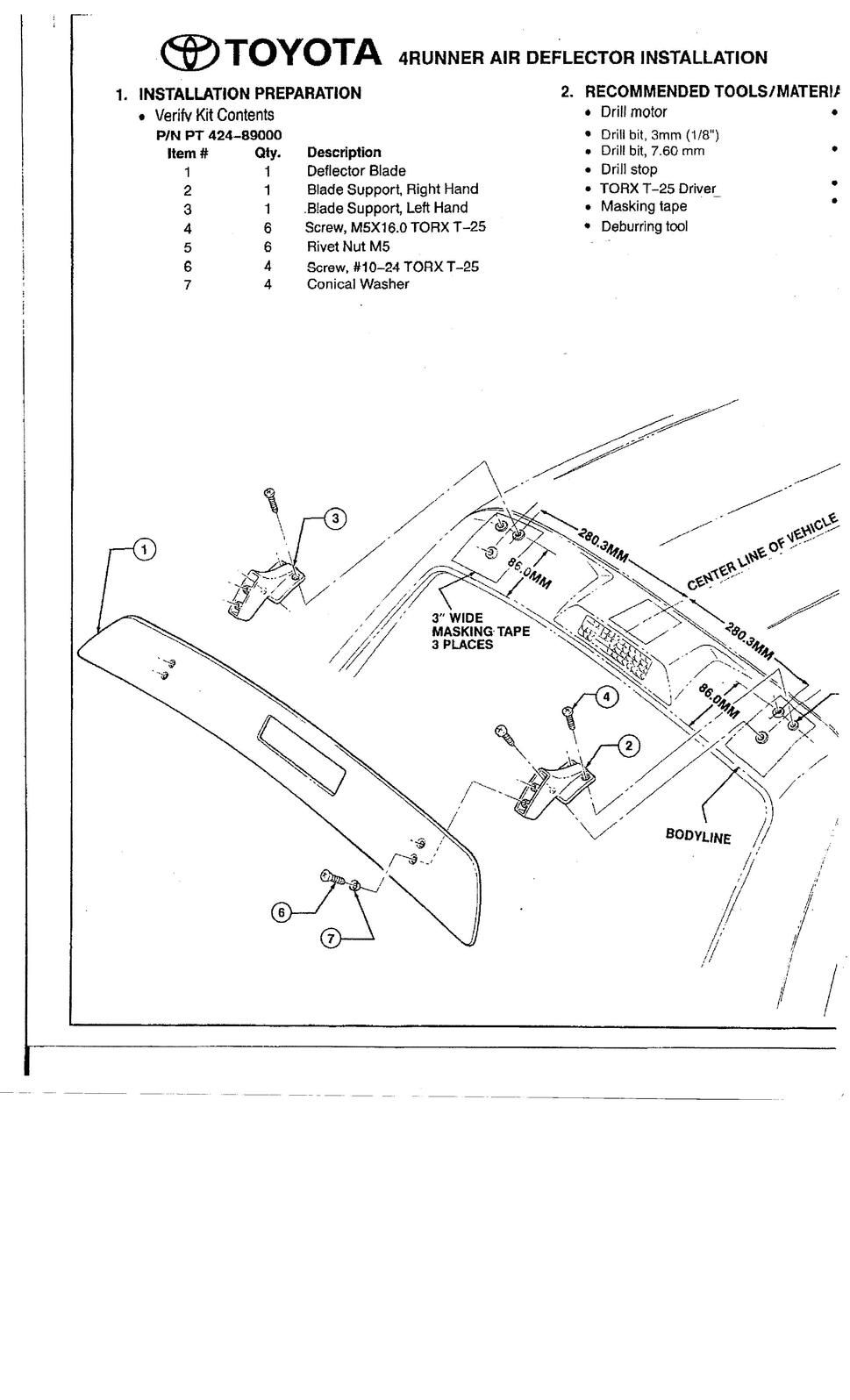

I believe I have attached the instructions here-if not just private message me with a real email address and I can send.
